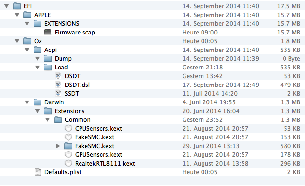

When I added either a DSDT or SSDT to /EFI/Oz/Acpi/Load/ the system would just stop at a blacked-out screen. They worked fine with Clover. After deleting the aml file and rebooting Oz created /EFI/OzAcpi and /EFI/OzDarwin folders.

RF, if you still have OzACPI/OzDarwin folders you need to try reseting and removing the Oz directory and let it do it correctly. That should not be happening, if it continues you will need to remove all drives except the one you want and it should be created correctly.
I've removed all the folders from EFI and let Oz rebuild the Oz folder. The OzAcpi and OzDarwin folders appear after an unsuccessful attempt to inject a DSDT or SSDT from /Oz/Acpi/Load.
When the system hangs at the black screen I reboot into my old Chameleon-powered install disk and delete the DSDT or SSDT from the Terminal. At this stage there's still just the Oz folder. Then when I reboot the OzAcpi and OzDarwin folders are created.

jacoweb, I don't understand what you have against using the Oz directory. I know we discussed this before but it still seems silly to me to not take advantage of using ESP for what you need.
Having everything load from bios along with using the most minimal configuration settings for Defaults is one of the main philosophies of Ozmosis. This is great if you have a "Quo" type situation where theres the chance that this is your first time booting/installing osx and Oz is your only means of doing so. Fortunately thats not the case for most of us.
The Oz directory along with a custom Defaults.plist, extra kexts that might be needed, maybe an added dev-prop.bin, a custom Theme.bin, dsdt/ssdt that can be edited at any time is all an necessary evil for hacks even if it goes against the true nature of Ozmosis. These things add convenience and better control for someone that wants to change things quickly or regularly experiments with different options we might need involved with hackint0shing.
If you are seeing OzAcpi or OzDarwin folders check if you have replaced FileSystem (93022F8C-1F09-47EF-BBB2-5814FF609DF5) with EnhancedFat (961578FE-B6B7-44C3-AF35-6BC705CD2B1F) and also check if you have added PartitionDxe/EnhancedPartition (1FA1F39E-FEFF-4AAE-BD7B-38A070A3B609).

Is it possible to use to ssdt? Because i have SSDT / SSDT-1 for powermanagement from my Clover Setup.
Good to know. I wasn't using either of these. Same with the Z68 but the OzAcpi and OzDarwin folders weren't appearing there.
no problem loading multiple ssdt's from ACPI/Load/ folder
cool! is it possible to add the oz folder to a usb drive? so i can mainly use it for boot. with my cust ssdt / default.plist?
when i mount efi partition on my osx drive, adding ssdt to oz/acpi/load.. seems like the ssdt is not loading.
maybe i do someting wrong! sorry for many n00b questions! ;)
