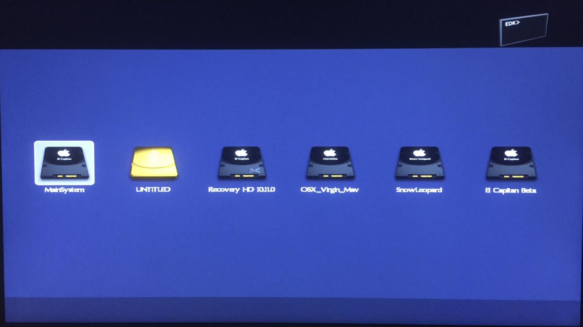

Just found time to d/l latest bios and extract new ozmosis. AFAICT all is good.
I also extracted theme from BIOS and I now see this:
It looks great for a beta, and I find keyboard arrow keys work as a selector. Nice.
P.S. F10 takes screenshot while in UI, use with care since BMP's are big(10MB on my display size) and to not fill the ESP space...
You will find them on /EFI/OZ/ folder.

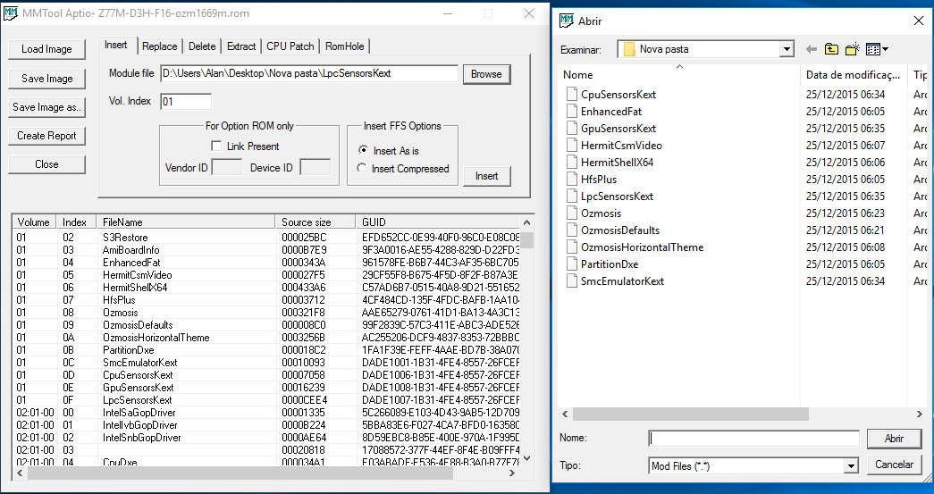

Problem in OZ167x: GUI not only works with the OzmosisHorizontalTheme, but it works the old theme OzmosisBlackTheme.
I did the following tests:
Files of Oz1669 with the OzmosisHorizontalTheme, the GUI appears, only the cursor does not appear correctly.
Files OZ167x with OzmosisBlackTheme, the GUI work as the OZ1669
Inserted in Rom all OZ167x files that can be seen in the image.

Like I saw in pictures and confirmed by your modified ROM, you did all wrong(or who made the rom)...
Dunno who told you to put those outside the nested volume, I think if you look on AOS BIOS is pretty much clear where those belong to be put, and that is inside the nested volume.
Anyway, for the first and the last time I made a ROM to show you and anybody else who don't know, how it should be done, including the MMTOOL report before/after so you can compare.
To all, before starting reporting "bugs" make sure you do your job proper first, and also do not "decide" by yourself what files are required or not.
