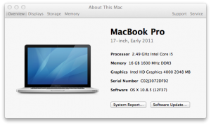

Thanks! This worked great for me.
Attached File  Untitled.png   92.84KB   53 downloads
I figured that with 16 GB of DDR3 RAM, I might as well go the whole way.

Hi Artur
So far, I have not really noticed much change at all.  I will continue to test/monitor performance and report back.  My laptop has dual graphics - the Intel HD4000 and the Radeon 7850M.  However, HP, the maker of my laptop, does not allow GPU switching in the BIOS, only in Windows software.  So far, OS X does not have any app to switch between the two GPUs.  That's why I wanted to add more VRAM to the HD4000.  It's the only GPU that works with OS X.  With 2 GB VRAM, Activity Monitor shows that I still have 10 GB free memory of my total 16 GB.  I am seeing no additional CPU activity and no increase in either CPU or GPU temperatures. Who knows, maybe this is all cosmetic and it doesn't really do anything.  I'll have to watch some HD 1080p videos and see how it performs playing those.
Thanks for your comments.
UPDATE:  I put the vanilla framebuffer kext back in S/L/E and ran some videos, 480p and 1080p, and went into some photo directories.  The 480p videos ran comfortably with the CPU at 1.19 GHz at about 52 C.  The 1080p videos ran with the CPU at 2.67 GHz at about 61 C and there were a few times where the video was a bit garbled.  The photo directory took a fairly long time for all the thumbnails to fill in.  With the modded framebuffer kext at 2048 mb VRAM, the 480p videos ran at about 1.29 GHz at 54 C, the 1080p videos ran with the CPU at 2.67 GHZ at 64 C, and the thumbnails filled in in the photo directory quite quickly compared to the vanilla framebuffer kext.  Also, the video at 1080p was flawless (and x-rated  :thumbsup_anim: ).  In summary, there was a bit more heat and only a very small extra amount of CPU usage with 2048 mb of VRAM compared to the vanilla VRAM of 384 mb.
