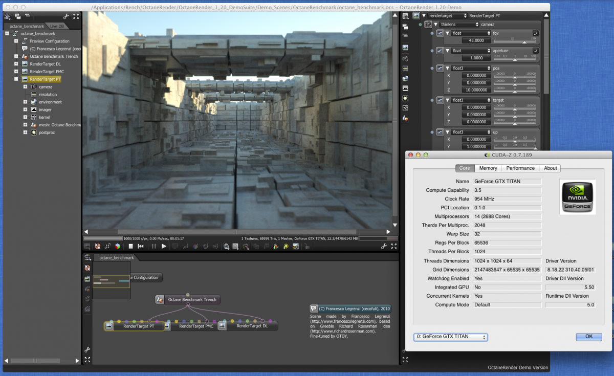

for about 6 months barefeat uses (beside LUXMARK OpenCL) OctaneRender , which is CUDA(Nvidia) only as benchmark.

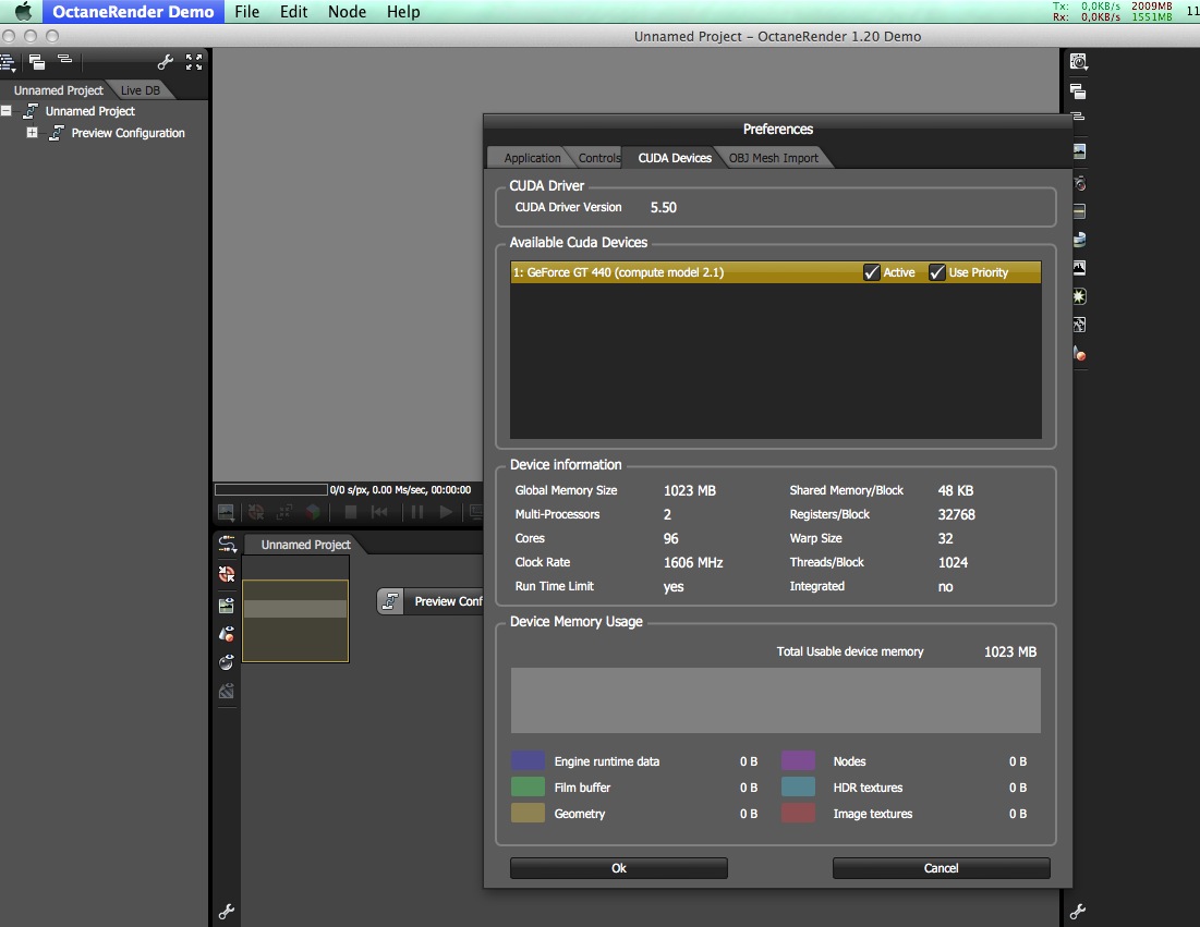

1. CUDA drivers (works also on 10.9 DP6 for me!) installed (no restart needed :) )
http://www.nvidia.com/object/mac-driver-archive.html

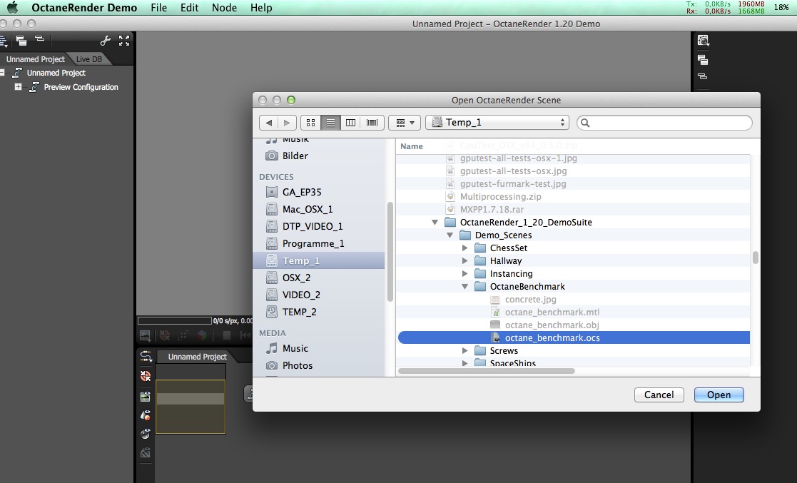

3. Octane Demo scene files
http://render.otoy.com/downloads/OctaneRender_1_20_DemoSuite.zip
To compare to barefeats results (lots since 6 Months on his site) http://www.barefeats.com/gpu680v7.html

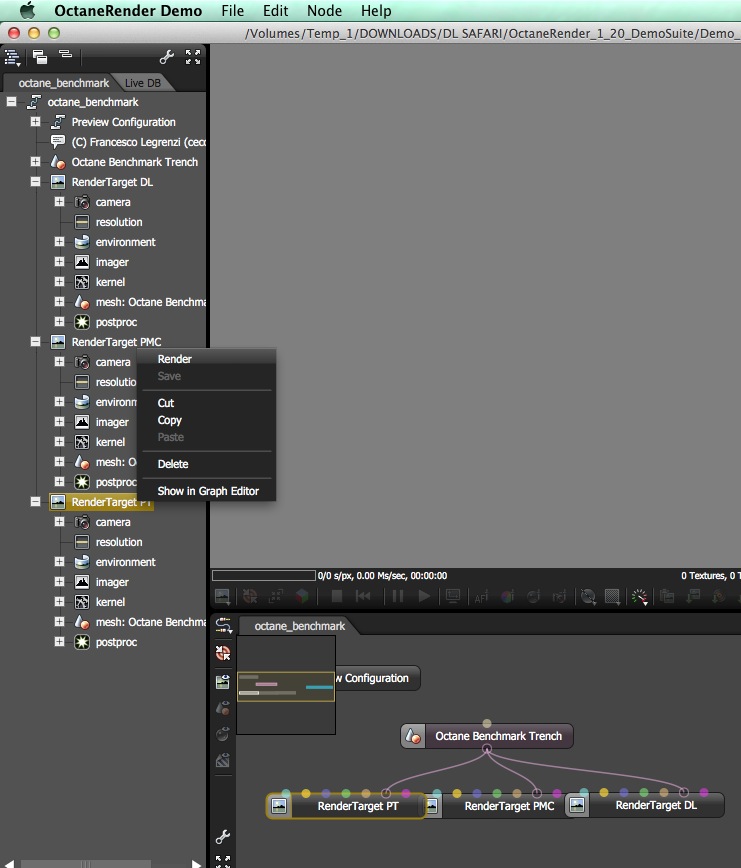

use the demoscene  RenderTarget PT
My GT 440 needs 15:52 Min:Sec for that scene.
GTX 680 (barefeat) needs only 3:09 !!!
Low End CUDA gpus may not work (not enough gpu features) like NVidia 8/9xxxx or GT 2xx.
CPU doesnt matter much (low cpu load).
Results:
GTX Titan (oc'ed @1132 Mhz): 1:17 minutes !!
GTX 780 1:22 / 1:29 (SC) / 1:40 Min
GTX 580 OC : 2:35 min
GTX 680 PHANTOM 4GB 2:53
GTX 680 (barefeat) 3:09 min
GTX 560 ti 4:05 Min
GTX 550 ti 7:56 min
GT 640 1Gb DDR-3 - 13:05 min.
GT 440 : 16 Min
GT 430 : 21 Min

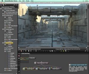

Open Demoscene and render the RenderTarget PT part.
Be patient ;)
