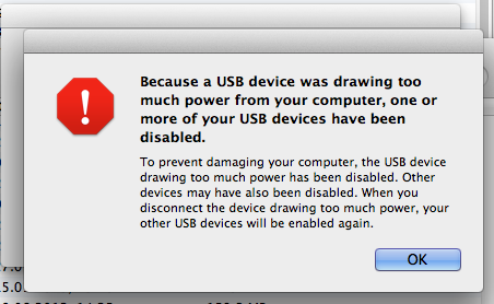

With V9 I had repeating follow message after wake:
now it will not appear.
But again. I can't mount USB stick after wake.

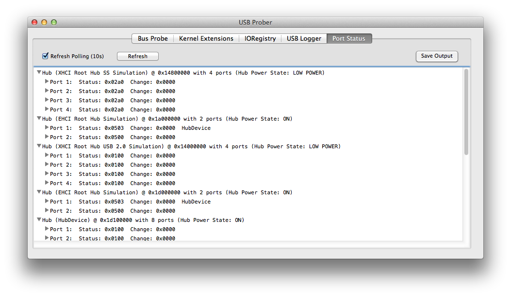

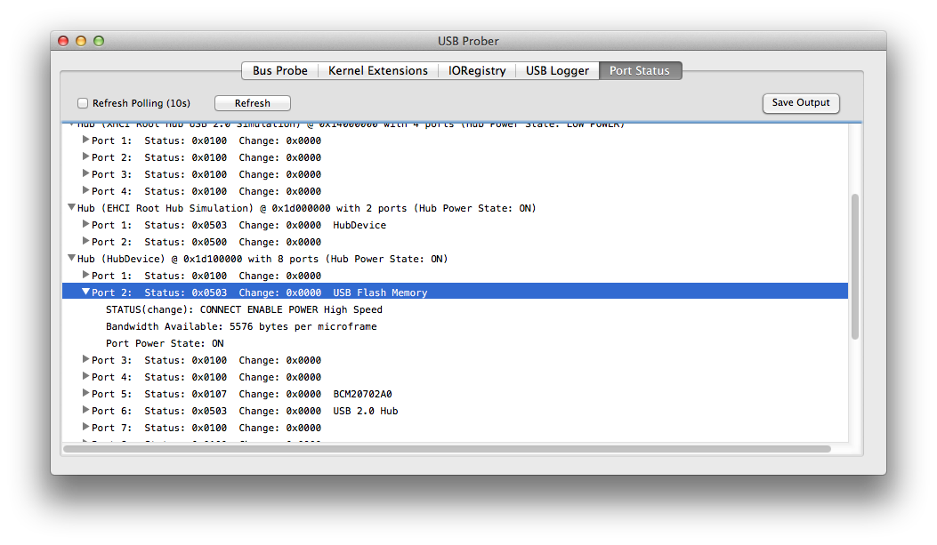

No USB2 device functions on Intel Panther Point and the power state keeps in LOW mode.
So on Intel Panther Point controllers we need original IOUSBFamily.kext with only AppleUSBXHCI, AppleUSBOHCI, AppleUSBUHCI and AppleUSBEHCI replaced.
Otherwise also always low power state... see below:
EDIT2: Hmm... still no go... seems to be the power parameters... gonna fix them...
EDIT3: Ok, gonna test new version (V12).
This should fix the USB3 problems on Intel Panther Point.
I modded the default current in AppleUSBXHCI and removed the added errata from IOUSBController's errata (seems not to work right)...
EDIT4: Aaargh! what's wrong with this picture... still LOW POWER even with no device plugged... very frustrating...
No... no go on Intel Panther Point decently... reverted to V9...
The device keeps getting stuck on LOW POWER, even with no device plugged in...
EDIT5: Ok... now I've got it to work installed only new AppleUSB*HCI kexts with original IOUSBFamily, unplugged everything, complete shutdown after clearing caches and boot again.
Now it works but it still complains about power when I plug in a USB2 device.
If I unplug it, it works again...

If I plug in a USB2 device (like my USB2 stick), it switched the status to ON however: it keeps on making new HSUserClients and never mounts the device.
USB3 HD works however...
EDIT7: With V9, if I plug in a USB2 device into USB3 port, it works and auto attaches on the correct EHCI port within seconds...
Did something change to the mux methods in AppleUSBXHCI? They don't seem to work right for Intel Panther Point  on V11/V12...
So for now, if you have Intel Panther Point, use V9... we need to sift this out...
@Slice, could you please check?
Second uploaded pic is with V9 (USB2 Flash Memory plugged into USB3 port and muxed on EHCI hub)...
It attached on EHC1 properly...
IOReg file with proper function is the second...

Ya, strange.
I see LOW POWER too but stick is working.
Then I press "Eject" and power becomes "ON". Error is in the USBProber?
