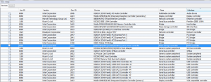

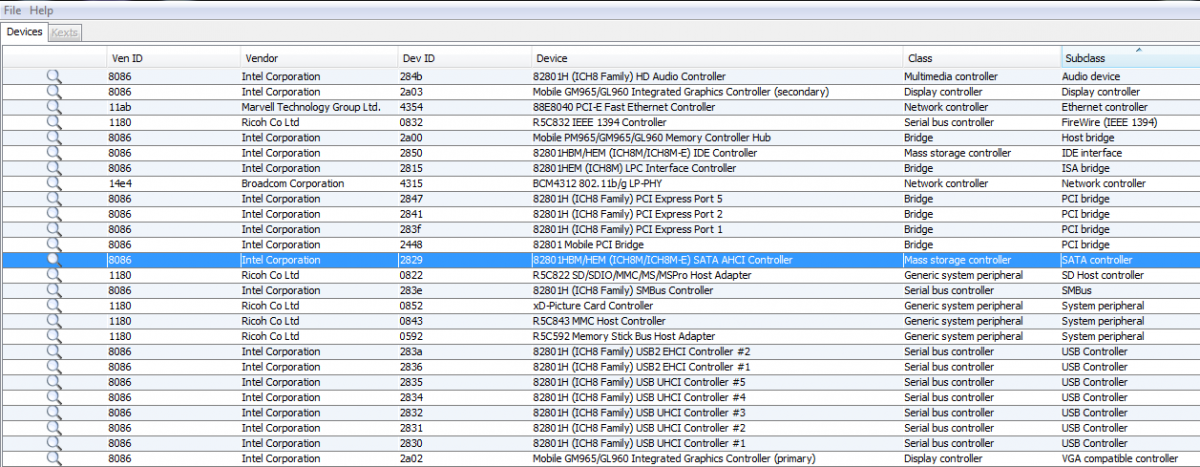

poolie360 Posted July 30, 2013 Share Posted July 30, 2013 Hey guys, I have a dell Inspiron 1525 that im trying to install osx 10.8.4 on but my harddrive doesn't show in disk utility, AHCI is on i have tried various kexts and had a go at editing my own but still no joy. Is there anything else that i can try? Any help is appreciated Thanks! Link to comment Share on other sites More sharing options...

poolie360 Posted July 30, 2013 Author Share Posted July 30, 2013 I wish this was the case it is definitely GPT, I tried editing my AppleIntelPIIXATA.kext to fix the problem is this the right kext to use ? Link to comment Share on other sites More sharing options...
