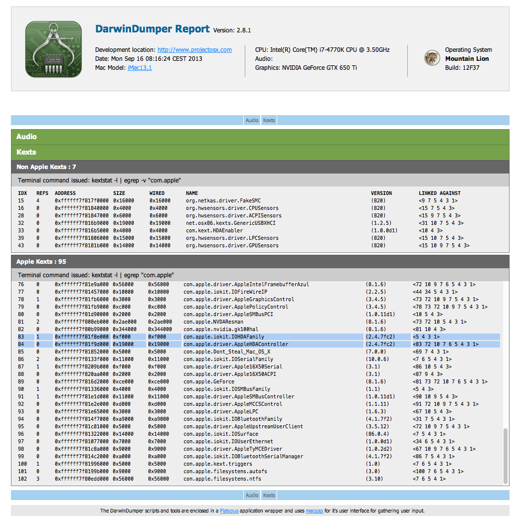

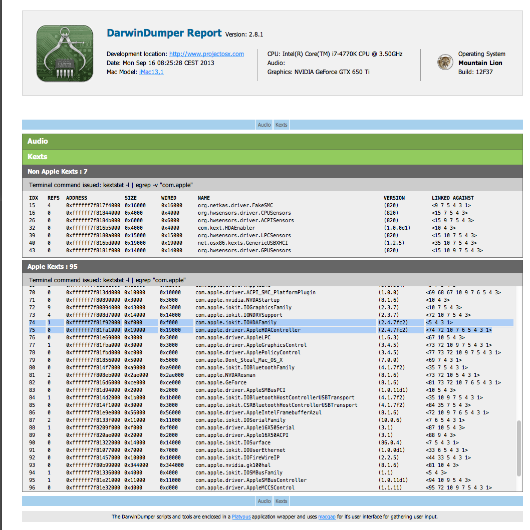

I used a software called Darwin Dumper after installation to check all the system.(Thanks iFIRE).

- Check Bios setting Defaults
- Disable video onboard.
- Run Darwin Dumper and check in kext files result if something it´s not working.

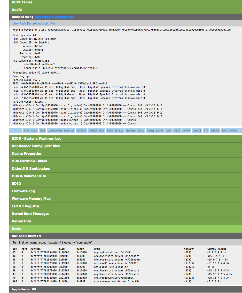

loaded bios defaults. enabled only hotplug at sata and disabled internal gpu.
- my applehda patched with toledas -85 script + hdaenabler1
- your applehda with hdaenabler898
- with voodoohda
- with voodoohda
after removing npci=0x3000 from bootflags its working!
