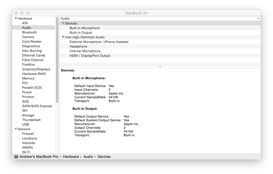

Ok when I connect the HDMI cable to my display, the only Output device is "Internal Speaker" My ID is the IDT 76E0 and my Clover config has all the patches for "KextsToPatch" from the config_4600.plist from your OS-X-Clover-Laptop-Config and the patch you have for the 76E0 located in your Envy-DSDT patch. Everything else works and I used your Readme for the Envy and got everything to build successfully and even am using your 76E0 injector which gave me sound and proper DSDT, so could it be anything else causing it? Thanks for the help, if it wasn't for your guide and the OP, I wouldn't have gotten this far.
Edit: Attached is my config and what System Information is showing for Audio devices

The framebuffer needs to be patched for HDMI-audio. There are some (disabled) patches in the config.plist you mention.
You also need injections/renames. "hda-gfx"="onboard-1" on HDAU/HDEF/IGPU. B0D3 (device at _ADR 0x00030000) needs to be renamed to HDAU. Some machines also require a patch to AppleHDAController (if native HDAU device is not recognized), or you can use FakePCIID.

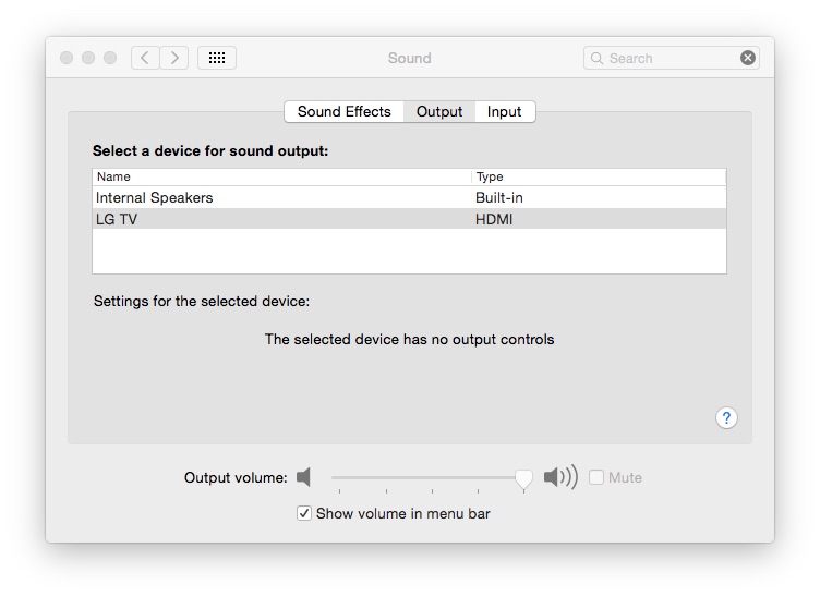

Thanks I got it. When I connect my TV the entry changes for AppleIntelFramebuffer@2 and the connector type is 00 04 00 00 not the 00 08 00 00. Also all 3 of the IGPU/HDAU/HDEF has the hda-gfx "onboard-1" entry. So which Clover Framebuffer patch will allow it to change to 00 08 00 00? I saw on the first page on this thread to change it, but the newer AppleIntelFramebufferAzul doesn't have the exact same keys in the same order. The port number for that Framebuffer@2 is 0x6.
Edit: I took your patch from your Envy Laptop repo as it had the same Clover Framebuffer patch posted on the first page to make the change and still the Framebuffer shows as 00 04 00 00. Is the patch in the config_4600 the newest one then to use? If it is, do I use the one labelled port 0204? I feel like we are so close as the frame buffer connector-type is the only thing that is not changed to the value you mentioned.
Edit: Woooooo I got the entry to show up! I enabled the rest of your patches for IOGraphics also and the 2 AppleIntelFramebufferAzul ones from your config_4600 file. Thanks so much!
Working, I assume...
