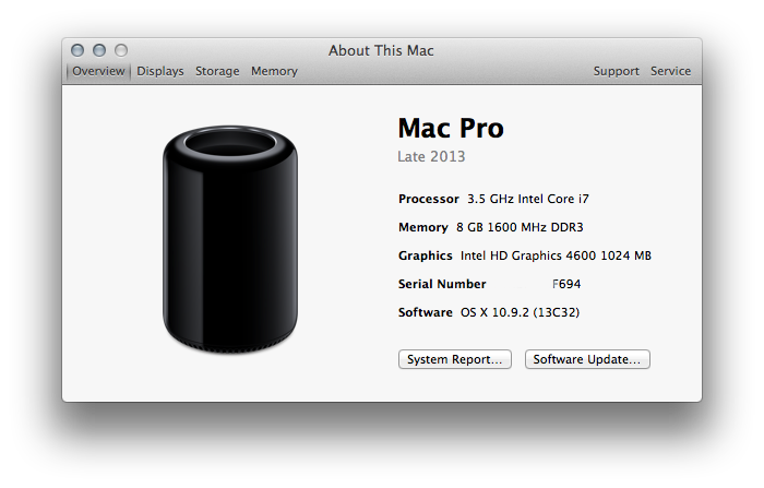

Hi everyone,
 I am new to the forums and am trying to get the integrated Intel 4600 graphics to work. My issue is that it is working intermittently. I can boot and sometimes after the verbose output for startup and the login screen is supposed to appear I get an image filled with snow/static. Other times it boots fine and I get the login screen and everything works fine.
 Here are a few things I have tried that didn't seem to matter:
  1. In the bios the memory settings for the Intel 4600 graphics was not 1024 like OSX thought so I changed it so they matched.
  2. Tried the DVI vs hdmi port from the motherboard.
  3. From an earlier post I followed these directions:
     For HD4600, add the following lines to org.chameleon.bool.plist in the Extra folder:
     <key>IGPlatformID</key>
     <string>0c260000</string>
     <key>IGPenabler</key>
     <string>Yes</string>
When it boots fine I don't have any issues, and the about displays as Intel HD Graphics 4600 with 1024 MB. I even ran cinebench and it worked fine. When it doesn't boot fine I am able to ssh into the box and see that it hasn't crashed, just no windows display. Are there any logs that I could check to see what is going on? The system.log file has more entries when it works for WindowServer then when it doesn't that process seems to be the one getting stuck but not sure why... Any insights would be greatly appreciated.
David.

  1. Do not change the VRAM setting in BIOS to 1024. Change it back to default which I believe is 64.
  2. No difference if you use the right default IGPlaformID eg 0D220003
  3. Only <key>IGPenabler</key>
         <string>Yes</string> should be enough and should default to IGPlaformID 0D220003
  4. <key>IGPlatformID</key> is only needed if you experience difficulties with default and need to overide and/or experiment.
  5. Which bootloader and what version are you using? All the above only applies to Chimera 2.2.1
  6. Good luck.
I had the IGPenabler set to yes but setting IGPlatformID seems to have done the trick. I tried a couple of different values but setting it to
0D260000 has allowed me to reboot 5 times and each time i get the login screen correctly when it comes back up so I think I am good now.
I also figured out I was using Chimera 2.2.1 as my boot loader, I didn't know since I just did the [url=&quot;http://www.insanelymac.com/forum/topic/279450-why-insanelymac-does-not-support-tonymacx86/&quot;]#####[/url] install and it installed it for me. Thanks for the help.
David.
