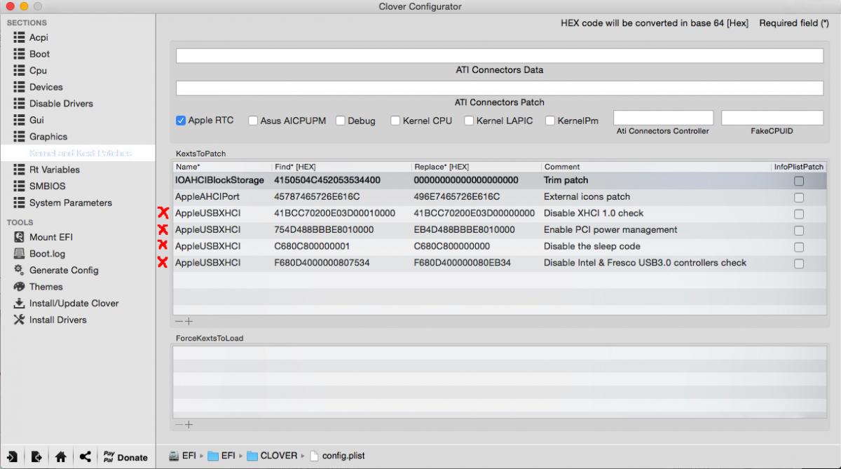

My SYBA SD-PEX50055 Combo card works very well but needs some USB 3 kext patches.
- SATA 3 part of this card uses ASM1061 chipset and works natively on OSX. SATA 3 ports are OSX bootable.
  Samsung 840 Pro SSD connected to this card scores 417MB/s Write and 436MB/s Read.
- USB 3 part of this card uses Etron EJ168A chipset and needs GenericUSBXHCI.kext to work:  http://www.insanelym...-x-with-source/
  or if you are on Clover bootloader use attached KernelAndKextPatches or Binaries from here:  http://www.insanelymac.com/forum/files/file/150-patched-appleusbxhci/#commentsStart

I managed to take an image from a video of what was wrong since it would disappear so quickly. I made a picture out of the different frames of the video and I think I found what the culprit(s) is/are although I'm not sure what to do from there:
com.apple.iokit.iobluetoothfamily
com.apple.driver.applemultitouchdriver
com.apple.driver.applebluetoothmultitouch
Here's the Image www.dropbox.com/s/qvpgrby2dft0j33/btkernelpanic.jpg?dl=0
What do you suppose I should do now?
when I had kernel panics before, usually there was only one culprit/kext that crashed. Here on your screenshot we can see that a lot of kexts IObluetooth/IOusbfamily/apple multi touch.
I am not sure if I can really help you since the patch works for me but I will try to steer you in the right direction.
1) please put your hardware information in your signature so that people will know what main board etc you have.
2) did you do any other patching with bluetooth/usb/multitouch other than the two patches mobster described? (clover inject and install of that BTfirmwareuploader). It might be that different patches interfere with each other.
3) consider opening a new topic just for your problem since this doesn't really fit into this topic here.
4) here is a lengthy post about bluetooth problems. I haven't read it completely but this is where I got information about the btfirmwareuploader from.
Good luck!
