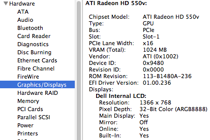

Did you see the change on About this mac>Graphics/Display?
Attached File  dis.jpg   166.45KB   1 downloads
Open Terminal and the execute command - ioreg -lw0 > ~/Desktop/ioregSaved.txt
And send the file, I will try for you.

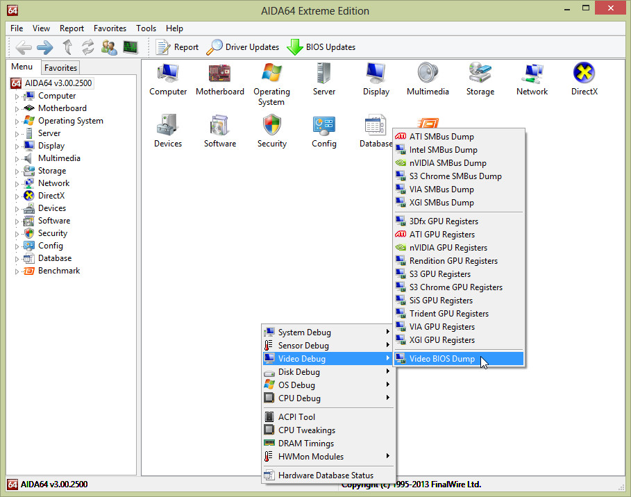

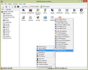

Download AIDA64 extreme version  - http://www.aida64.com/downloads
Install, Run the program, right click on bottom of the windows of this app. , do as pic & click on video bios dump
Attached File  Snap2.jpg   190.98KB   1 downloads
Save the file, done :D .
