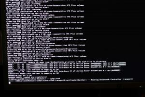

Boot with -s
fsck -fy
mount -uw /
cd /Volumes/your_partition_name
mkdir /kext_backup
cd /Volumes/your_partition_name/System/Library/Extensions
mv AppleIntelHD* AppleIntelSNB* ATI* GeForce* NVDA* /Volumes/your_partition_name/kext_backup
reboot
Replace your_partition_name with the name of your OS X partition, obviously.
If the name has spaces, use " "
ex cd /Volumes/"Mountain Lion"
Reboot with GraphicsEnabler=No
This solved the Bluetooth issue that I and some others were having for me, putting it here for future reference.
Issue image (credit goes to majusss):

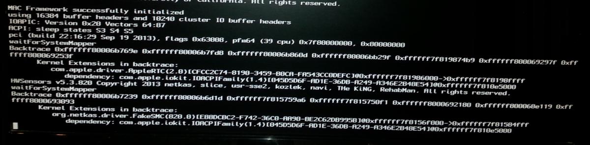

Does anyone know what this kernel panic is all about:
I seem to get it from both the installer, and post installation unless I use -x -f and after installing my DSDT I get it no matter what I do.

Hey guys,
I have a problem and I don't know how to solve it.
I installed OSX Mavericks and when I boot with -v I got the error in the attached file.
Please help me :D
Boot with -x and install the latest HWSensors package
