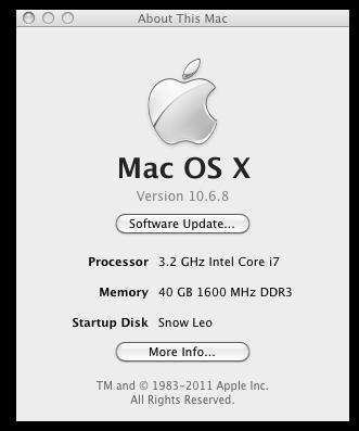

Because I constantly use Kontakt’s sound library under Logic I needed to upgrade my RAM to 40 GB. This amount of RAM memory would be enough for me. So, I bought two 8GB sticks and now I have 40 GB RAM inside my machine.

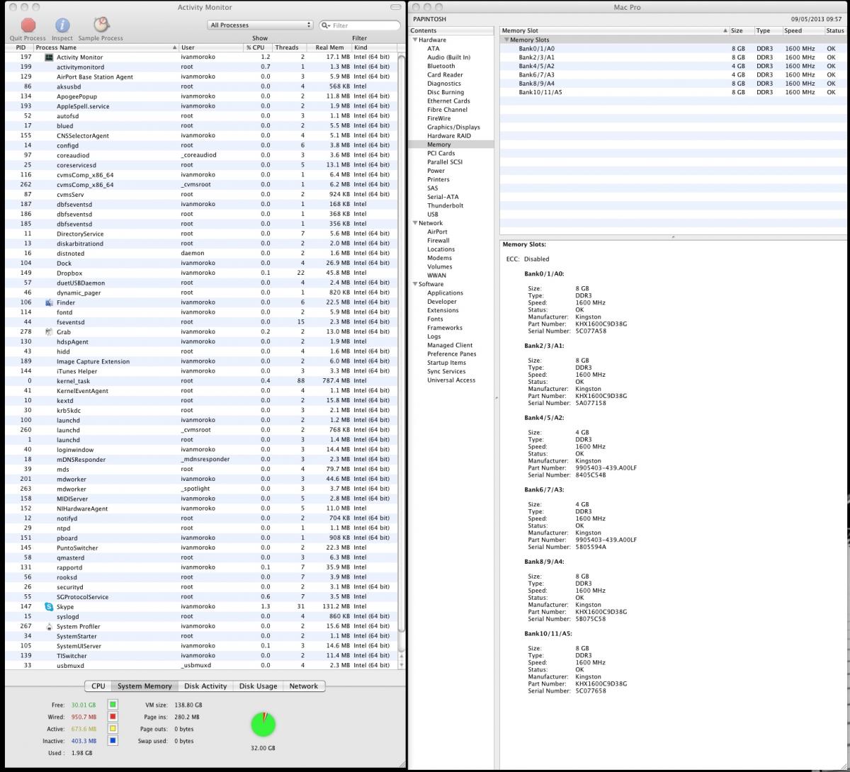

The System Profiler shows the 40GB is recognized (see the picture). But when I open Activity Monitor (System Memory page) to see what's going on, I find that the pie graph only shows 32GB (see the picture).
What’s wrong?
What do I need to do to get Snow Leo to recognize the whole amount (40GB) of RAM, not to ‘see’ 32GB only?

Install the latest version of Chameleon.
See commit 2203: http://forge.voodoop...ce/commit/2203/
Hopefully that fixes this bug for good.
