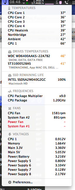

and this too!!! mine :fiery:
Attached File  Captura de pantalla 2013-05-09 a la(s) 20.48.05.png   96.78KB   49 downloads

@ iFIRE.From your temp seems you need better cooling or more fans , as your h/ds are more than i would like.
as your ambent temps are high anyway the only thing is to try and get the hot air out as fast as you can. ie positive pressure in the case forcing hot air out
@giofrido you could try a extra fan to help you gpu as a temporary mesure
