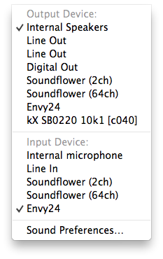

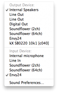

theconnactic Posted May 5, 2013 Share Posted May 5, 2013 Hi! Soundblasters will work with the KX Driver by Eugene Gavrilov. But only the output, unfortunately. I have a Live! 5.1 - the sound will be loud and crisp, good for games, and will be recognized as a Creative card, meaning no stuttering with some picky games. I also use a M-Audio Audiophile 2496. Works just fine, both inputs and outputs (no input control, meaning all signal will enter with maxed gain) with Envy24 drivers. I use it with Logic 9.1.8 without a single glitch. No MIDI in/out for both of the above cards, unfortunately, despite both being MIDI capable - such a pity, the development for both KX and Envy24 was abandoned (perhaps because of the abundance of cheap USB solutions, pushing legacy PCI hardware further in the obsolescence). All the best! 1 Link to comment Share on other sites More sharing options...
BALDY_MAN Posted May 5, 2013 Share Posted May 5, 2013 I have M-Audio Audiophile 2496. it depends on the installed memory. because i have 32 gig i must add. himemory_mode=2 in boot plist for it to work.also depends what kext you use for sleep to work. Link to comment Share on other sites More sharing options...
theconnactic Posted May 5, 2013 Share Posted May 5, 2013 I use no kexts and no special flags: it works pretty out of the box under 10.6.x-10.8.x with Envy24 drivers, at lest for me. But then again my machine have a quarter of the RAM as yours. Sleep works flawlessly, including auto sleep, with no kext at all. I use both cards at the same time, plus native audio (ALC 887) and HDMI audio (Intel HD 4000), switching seamlessly between then (or using them at the same time, sometimes each one routed to a different app, or using the inputs of one and the outputs of the other for the same DAW) with no glitch or performance loss - this used to be a pain it the OS with Windows 7. All the best! Link to comment Share on other sites More sharing options...
