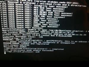

Hello updating from 10.8.2 I've some problem it won't boot this is the image that appear to me :
Processor : Intel i73770k
montherboard : p8z77-v deluxe
graphics : nvidea 680 gtx
hd : ssd 512 gb samsung
ram : 32 gb

I think it's about VGA Kext. If You Still Have VGA Kext From 10.8.2 you can use it. I Hope you still Have it.
try booting with -x or single mode if necessary.

Hi,
Any onboard graphics?
Boot with -s and type the following:
mount -uw /
rm -rf /System/Library/Extensions/Geforce.kext
rm -rf /System/Library/Extensions/NVDAStartup.kext
rm -rf /System/Library/Extensions/NVDAGK100Hal.kext
shutdown -r now
Boot with -f -v after that.
If no onboard graphics, it should boot into VESA mode.
