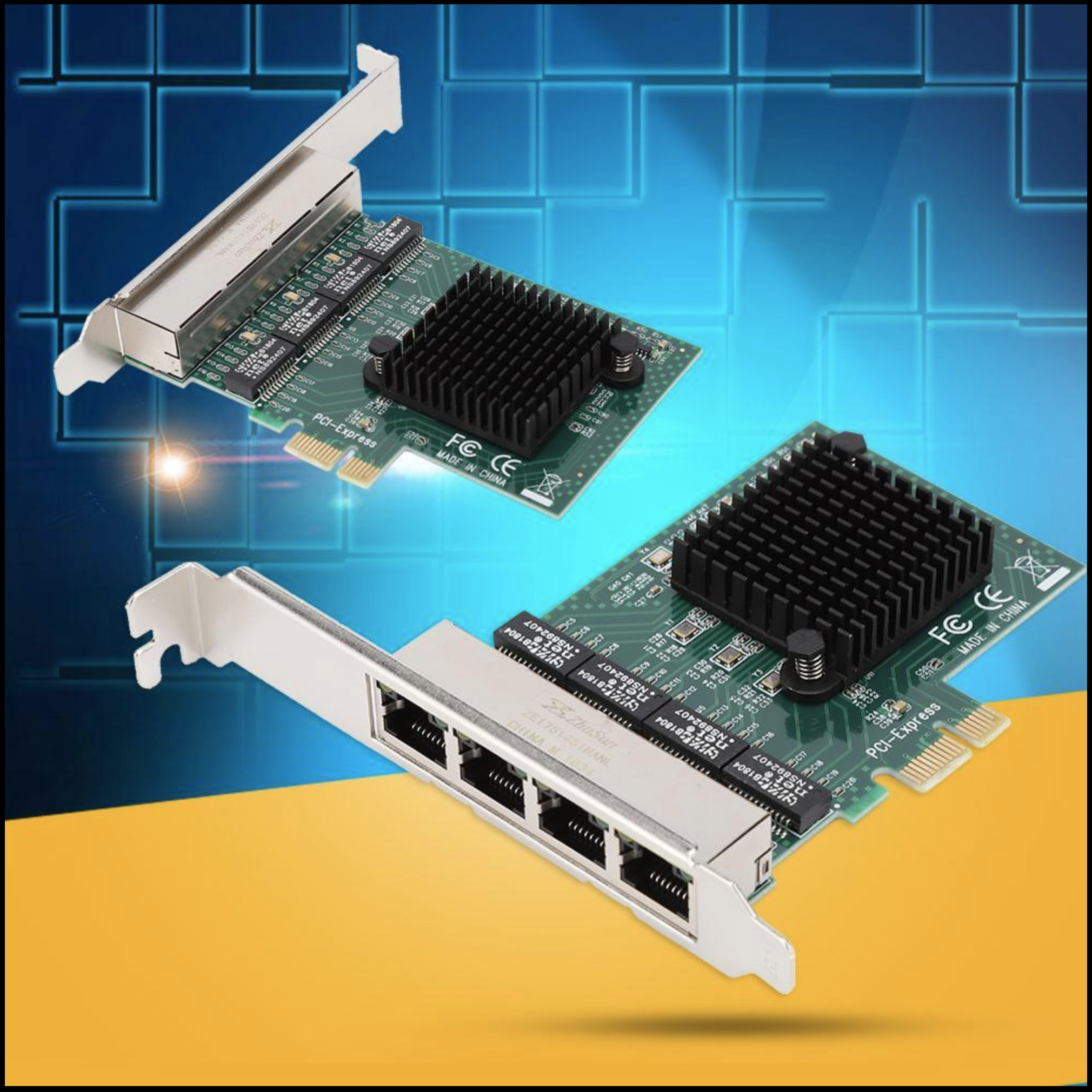

Can i use this network card with Z390 UD, or with any mainboard can?
With kext RealtekRTL8111-V2.3.0d7.kext (And can I do Link aggregation?, I already have a switch properly configured)
Card: Rtl8111G 4 port
Thanks for reading and replying
