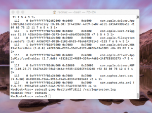

Hello. I've been using your kext for many years and it has been flawless until recently. In that last week or so I keep getting constant drops. I can actually see it happening in Outlook because it will drop connection. The only thing of any substance that I have changed is updating Clover. I do this regularly.
I normally have RealtekRTL8111.kext installed in Clover's kext folder but moved it into S/L/E to test but it still does the same thing. Here is just a sample from Console output:
Oct 19 13:02:37 MacPro kernel[0]: Ethernet [RealtekRTL8111]: Link down on en0
Oct 19 13:02:39 MacPro kernel[0]: Ethernet [RealtekRTL8111]: pollIntervalTime: 170us
Oct 19 13:02:39 MacPro kernel[0]: Ethernet [RealtekRTL8111]: Link up on en0, 1-Gigabit, Full-duplex, No flow-control
Oct 19 13:04:13 MacPro kernel[0]: Ethernet [RealtekRTL8111]: Link down on en0
Oct 19 13:04:16 MacPro kernel[0]: Ethernet [RealtekRTL8111]: pollIntervalTime: 170us
Oct 19 13:04:16 MacPro kernel[0]: Ethernet [RealtekRTL8111]: Link up on en0, 1-Gigabit, Full-duplex, No flow-control
Oct 19 13:07:43 MacPro kernel[0]: Ethernet [RealtekRTL8111]: Link down on en0
Oct 19 13:07:49 MacPro kernel[0]: Ethernet [RealtekRTL8111]: pollIntervalTime: 170us
Oct 19 13:07:49 MacPro kernel[0]: Ethernet [RealtekRTL8111]: Link up on en0, 1-Gigabit, Full-duplex, No flow-control
I reinstalled it today strictly following your instructions to see if that may have been the issue but still getting the same result.
I have attached output of "grep kernel /var/log/system.log"
I really appreciate any help. This is making me crazy and confuse since it just started happening.

The kernel log doesn't exhibit any sign of a driver issue. Either way it's a hardware problem or a wrong BIOS setting. Check the LAN related BIOS settings again. In case it doesn't help, check the hardware (dust on the connector, broken cable or switch).

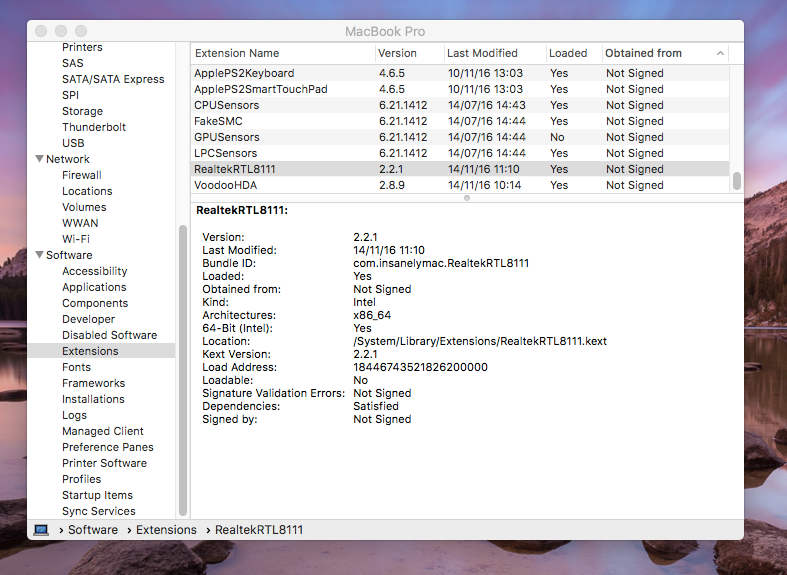

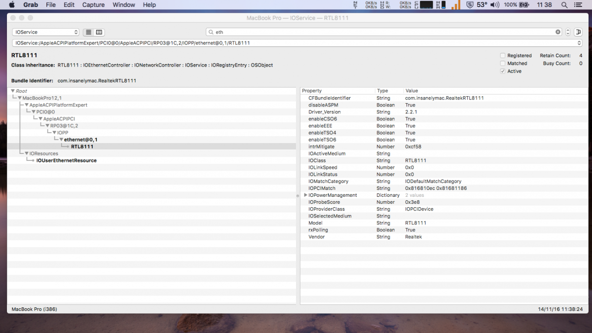

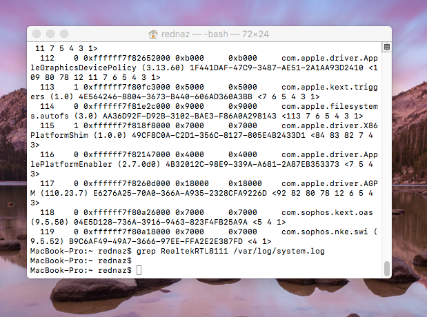

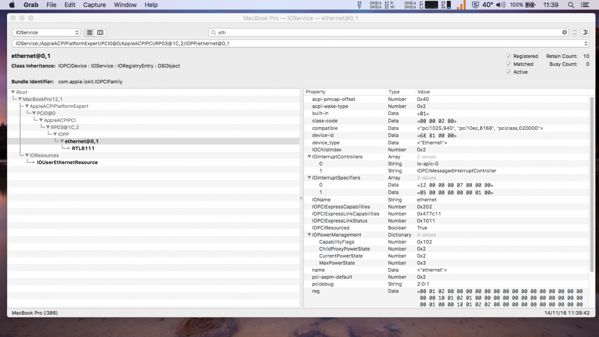

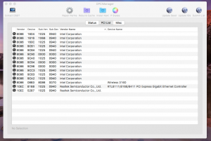

Hello Mieze,
If you could help-me, I need your advice :)
I am running a Sierra 10.12 on an Acer Aspire E5 571, i7 5500U and HD 5500, Clover - UEFI. I tried your RealtekRTL8111 v2.2.1 without success. I followed your "readme" and got this error “region #2 not an MMIO resource, aborting” during the boot.
My System Preferences shows:
I tried terminal command “grep RealtekRTL8111 /var/log/system.log” without luck:
My DPCIManager shows:

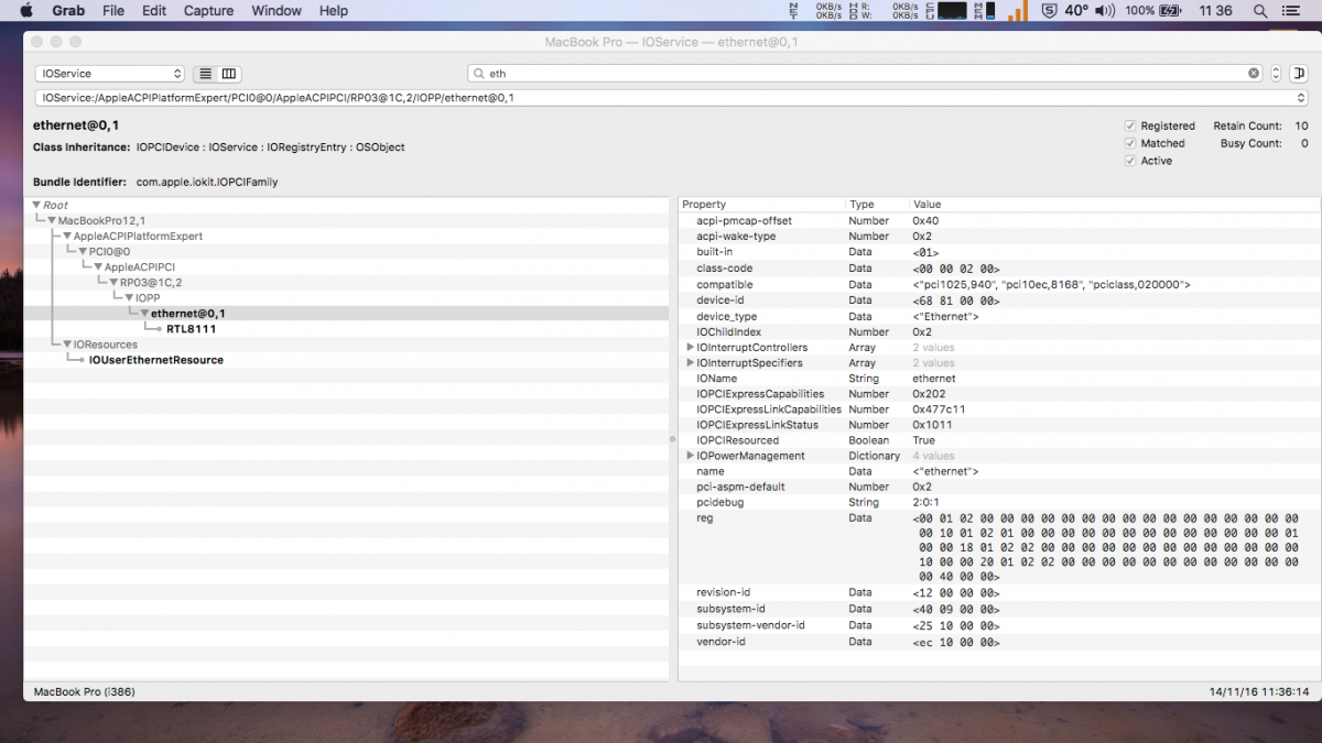

And the IORegistry related with RTL8111:
And the IORegistry related with Ethernet:

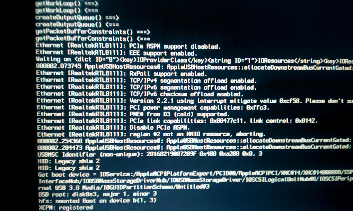

Also I tried your Debug version and "enableEEE = false/" , same result. Other problem related is that when I shutdown, using RealtekRTL8111 v2.2.1, my system reboot. Without your kext the shutdown goes well.
Attached my boot.log and below the AIDA64 info about the Realtek RTL 81111:

I am missing anything? Could you help me? Can I help you with more information about?
Thank you

Hello Mieze,
This is an issue with the BIOS settings. Something is still in control of the NIC preventing the driver form taking control. Disable the UEFI network stack and LAN boot in the BIOS setup. If this helps, congratulations, in case it doesn't get a new machine because there is nothing I can do for you, sorry!

Thank you Mieze,
I double check the BIOS, again. Networking Boot is Disable and Wake on Lan also disable, :(
I just saw that my Boot Priority order has two options, the last two in fact: Networking Boot IPV4 and Networking Boot IPV6, but i can not delete them.
Well, thank you!

Check the BIOS settings again for hidden entries affecting the NIC. Don't give up until you have check each and every entry. Unlike traditional board manufacturers, desktop and notebook vendors sometimes do strange things in their BIOS. Good luck!

Hi mieze i have this problem too. But sometimes after reboot my ethernet is working. I posted screens in this post - http://www.insanelymac.com/forum/topic/317933-realtek-8168-doesnt-work/
Once again, this is a BIOS issue and I can do absolutely nothing about it inside the driver.

hallo frau mieze, perhaps the new driver from http://www.realtek.com.tw/ would fix some problems in recent posts? :) your latest version works perfectly on 10.12.1, but maybe some other people need it. ciao
I'm aware of the new linux driver, I checked the code and came to the conclusion that there is nothing in it which would be a benefit for OS X. By the way, the error some users are reporting is a BIOS issue affecting only machines from Acer and Dell and in no way limited to a specific NIC. Atheros NIC's are affcetd too. The problem is that OS X fails to map the NIC's register space into kernel address space and there is nothing I can do about it.
baseMap = provider->mapDeviceMemoryWithRegister(kIOPCIConfigBaseAddress0, kIOMapInhibitCache);
    if (!baseMap) {
        IOLog("Ethernet [AtherosE2200]: region #0 not an MMIO resource, aborting.\n");
        goto done;
