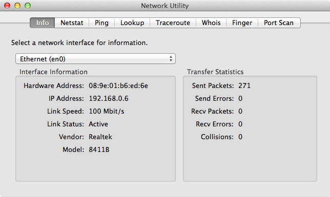

I just started using this driver with my Asus p7p55d and so far it has been the best out of the ones I have tried (lnx2mac's was one).  I am noticing one weird issue and I am not sure if it's a problem with the driver or maybe if it's something DSDT related.  WOL worked for me after I first installed this driver.  After I rebooted the machine, WOL will no longer work.  I have to shut down the computer and unplug the power cable then plug it in and turn it on.  After doing that WOL will function as it should until I reboot again.
Any idea on what is going on here?
BTW I'm running 10.9.1 and I compiled the kext myself.
This is normal behavior for 10.7+. Add darkwake=0 to kernel boot arguments to disable.

Acer V5-572G, RTL8411B, Chipset 25.
Unable to get an IP address via DHCP, end up with self-assigned IP.

thanks for the debug data. Please repeat the tests for chipset 24 with a gigabit connection. Also take a look at network statistics (rx/tx packets). At first glance it looks like there are no packets going in or out.
@Skvo: What about the network statistics?

According to Network Utility, only packets going out. I don't have a gigE connection ATM, so this will need to wait until later (about a week). When I am closer to my normal network config, I'll update here.

Looks like the link change patch code is not ok. I almost expected that to happen because in the underlying linux driver they reinitialize the NIC completely after the link comes up. As this makes things more complex and the r8169 driver doesn't follow that scheme either, I decided to try without a complete reinitialization. Maybe I have to rethink my decision in case I won't find out what is missing.
By the way, you can connect directly to the other machine in order to get a gigabit connection.

Tried it and the results are the same.
