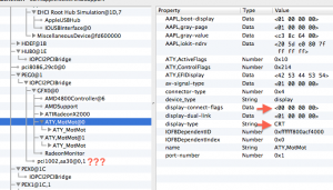

I always had problem with my display sleep on my old sapphire radeon hd4830 512mb card (it worked once perfectly but I don't have an idea why it worked for that 2-3 days), when osx should disable the monitor, the screen just freezes but the display not going into standby mode.
If I plug my display into the other DVI connector on the card (it have 2 DVI and one s-video) then display sleep works perfectly BUT my display not recognized properly and I have 800x600 resolution.
So I plugged my display back to the first DVI port (where I get 1920x1080 and everything but no display sleep) and checked my system in ioregistryexplorer and found some strange things:
Attached File  gsdhsh.png   109.04K   18 downloads
FIRST: it says my display is "CRT" but my display is LCD and OSX recognizes it nicely in about this mac and loads specific the color profile for it automatically.
SECOND: no connect flags, it's totally zero.
THIRD: what is that "pci1002,aa30@0,1" thing there? My vga card IDs are not equal with that and I don't have anything in DSDT.aml there.
Is anyone have an idea what is the problem with my setup? Do I need to modify ati-personalities?
Maybe someone have some DSDT.aml tweaks for my problem? I tried to inject connect flags and such via DSDT.aml, but they just won't get injected.
Please if anyone have some idea, let me know.
edit: I forgot: If I plug the monitor into the other connector, it still appears in @0 section, not in the @1 section.
Problem solved by using Cardinal framebuffer instead of Motmot!

Maybe the connector type in ati-personality should be changed to VGA type or something?
I read some tutorial about customizing the ati-personalities, but I couldn't figure out how to find the existing motmot personalities in the ATIframebuffer binary file (to know what should be changed).
#6
nyolc8
nyolc8
    InsanelyMac Sage
  • Members
  • PipPipPipPipPipPip
  • 462 posts
  • Gender:Male
  • Location:Budapest, Hungary
I tried to use the default "RadeonFramebuffer", and no screen tearing, full resolution, DISPLAY SLEEP WORKING, BUT I have a second display recognized which doesn't exist. So 99% that display sleep is a framebuffer issue.
Is there a way to edit ati-personalites without installing the developer tools?

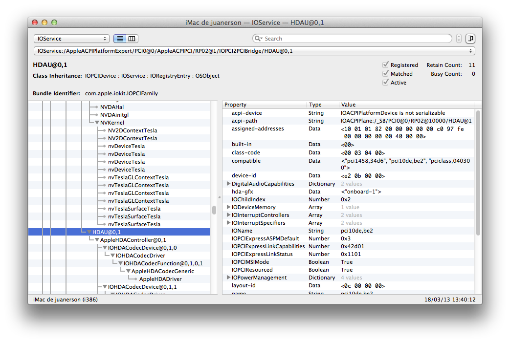

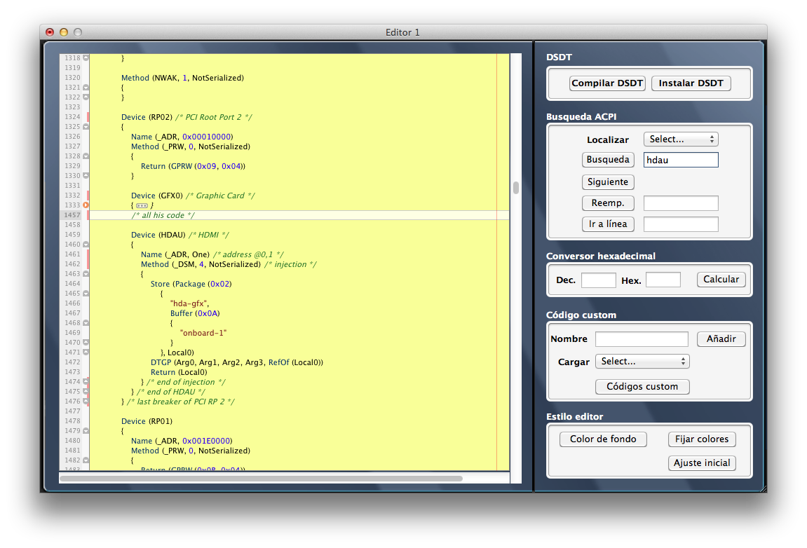

By the way @0,1 (address = ADR in dsdt = 0x01 or One) is HDMI, usually called HDAU. You can add it in the right place, for example:
Attached File  Captura de pantalla 2013-03-18 a la(s) 13.37.29.png   225.02K   15 downloads
The result in IOReg, using patched AppleHDA (ALC888 in my case) to avoid sound assertions in log console:
Attached File  Captura de pantalla 2013-03-18 a la(s) 13.41.19.png   211.9K   14 downloads

So the "pci1002,aa30@0,1" device there (see picture in the first post) is the hdmi audio device on my graphics card, right?
#10
juanerson
juanerson
    InsanelyMac Legend
  • Local Moderators
  • 1,119 posts
  • Gender:Male
  • Location:Tru, Venezuela
Yes. But as I tried to say, please sorry for my English, that device is NOT present (do not exist) right now in your DSDT.
