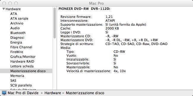

Blame73 Posted April 2, 2013 Author Share Posted April 2, 2013 Ho risolto installando l'ApplePCIIDE per la mia JMicronATA (JMB363) trovato qua su IM: http://www.insanelym...a/#entry1838225 Posto anche qui il Kext: ApplePCIIDE (JMicron 10.8).zip Link to comment Share on other sites More sharing options...
