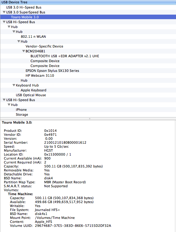

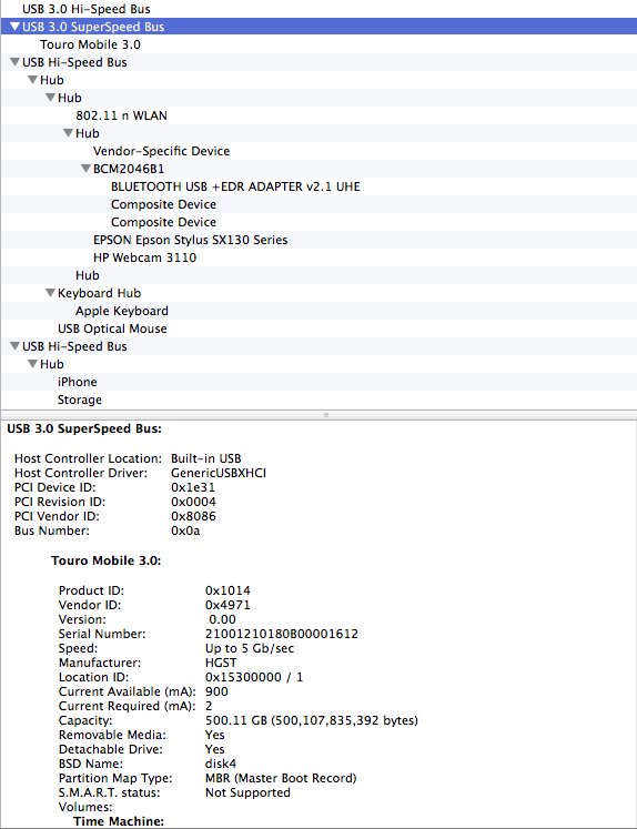

Got it. Just to make it clear, here is what happens here.
These shots are from System Information. Command+R once there refreshes what you see.
First, this is my USB Device Tree:
Don't ask me why, but the only real USB 3.0 speed is the "USB 3.0 SuperSpeed Bus", which is where I have attached my card reader.
Even though the USB Receiver and the Bluetooth are USB 3.0, they are not "super speed".

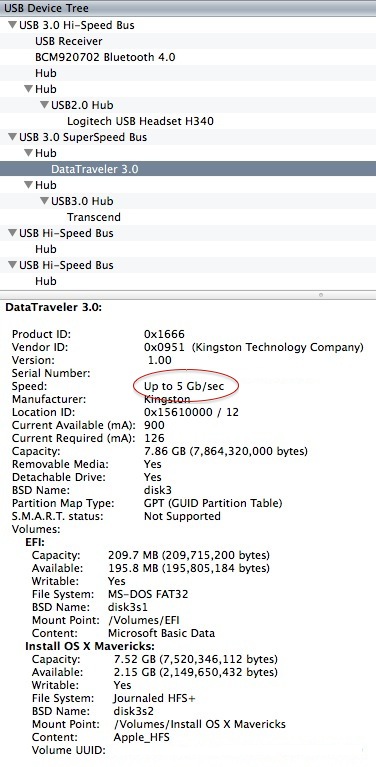

So when I plug in the DataTraveler 3.0, after a refresh (command+R) here is what I get:

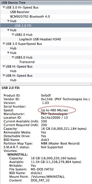

If I remove that drive and plug in a USB 2.0 one, on the same port and refresh, here is what I get:
Now, I'll put back the DataTraveler, refresh, and I just confirmed it is still 5 GB/s. However, after a sleep / wake, I'm greeted with warnings that the volumes were not ejected properly, but more importantly, here is what I have now in System Information:
As you can see, everything is messed up right now, DataTraveler isn't even recognized anymore. Removing it and reattaching it doesn't make it show up again, but the other pen drive USB 2.0 does show up if I plug it in there. The controller has gone completely mad, or OS X's XHCI drivers, I don't know.
