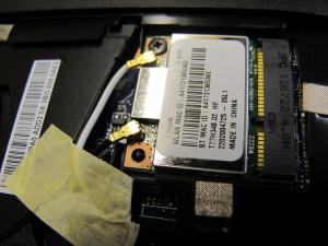

Attached File  WC.JPG   114.88KB   3 downloadsWell I've opened the laptop up and I'm guessing this is a half size card, Macbook air cards will not fit by the look of things so,
can anyone recommend a combination wireless/bluetooth card that will fit my laptop and be compatible with 10.8.2.
I'm not too bothered if bluetooth doesn't work as long it has bluetooth that I can use in windows or linux.
Mike

AR5B91-X or BCM94321MC
They both appear to be too big :(

OK I've just ordered an Atheros AR5B93.
I know it doesn't have bluetooth but I have a very small bluetooth dongle that works with osx and for the few times I use it I can live without it.
So fingers crossed by the end of the week I will have a fully working Acer V5-171 :)

Wow, the card turned up this morning about 10am :)
Just fitted it and it works right OOB :)
System just needs some fine tuning but at least it's usable.
Thanks iFIRE.
