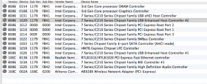

ifire which controller i should look at #2?
#10
iFIRE
iFIRE
    InsanelyMac Deity
  • Moderators
  • 2,475 posts
  • Gender:Male
  • Location:Bcn-Spain
Edit in your DSDT
in EHC1  is 1e26  = 0x26 0x1e  0x00 0x00
in EHC2  is 1e2d =  0x2d 0x1e  0x00 0x00
