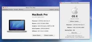

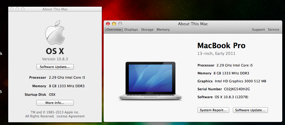

Attached File  Screen Shot 2013-02-16 at 5.09.29 PM.png   209.87K   120 downloadsAttached File  GB.png   93.17K   162 downloadsAttached File  LOW VOLT.png   321.83K   160 downloadsAttached File  High VOLT.png   387.58K   145 downloadsAttached File  TP.png   132.56K   172 downloads

Works:
  • CPU with turboboost (Speedstep)
  • Wifi  <-----5830TG User may not work (researching)
  • Ethernet
  • HD 3000 GPU (full)

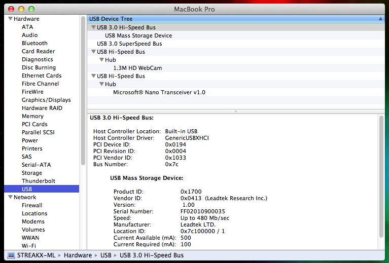

  • 2 USB 2.0 Ports + USB 3.0 Port (See UPDATE 4 for USB 3.0 kext)
  • Audio (Speaker/Headphone) + volume control
  • Shutdown, Restart, Sleep (Lid and button)
  • Brightness control
  • Battery
  • Keyboard/Mouse
  • Multitouch Enable Trackpad
  • Dual Boot with Windows 8
  • WebCam
  • iMessage (FIXED)

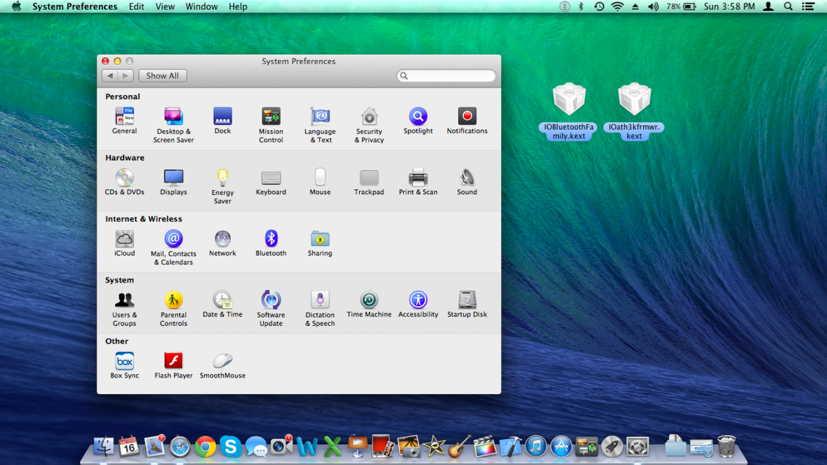

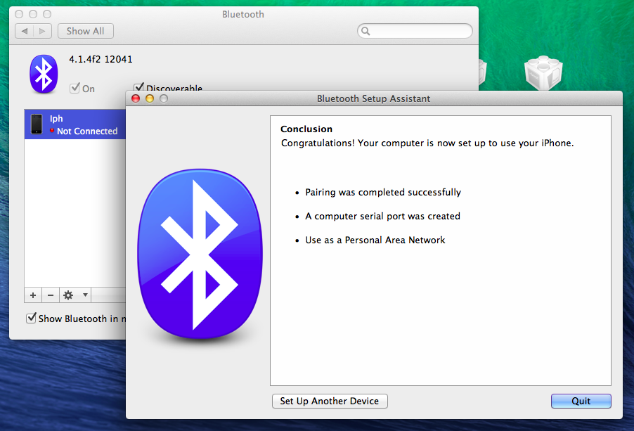

  • Bluetooth (There are solutions out there)

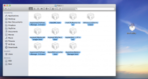

  • Unzip 4830TG kext.zip
  • Patch all kext Inside Folder [PATCH 1] using Kext Utilities Attached File  P1.png   347.27K   236 downloads

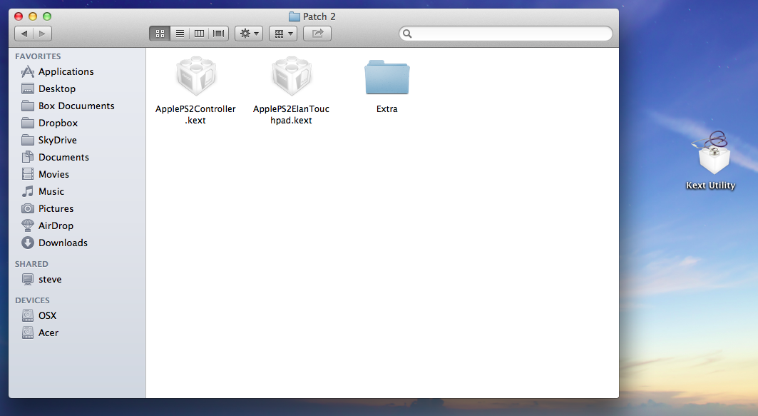

  • Patch all kext Inside Folder [PATCH 2] using Kext Utilities Attached File  P2.png   251.47K   267 downloads

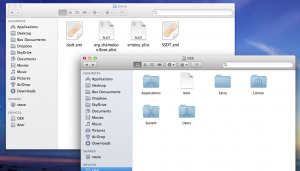

  • Drag all Files inside Extra (in PATCH 2) to ~/Extra and replace all Attached File  EXT.png   286.08K   305 downloads

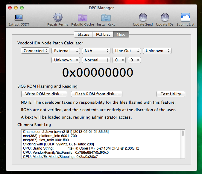

  • Rebuild Cache/Repair Permission Attached File  Screen Shot 2013-02-16 at 5.21.30 PM.png   154.84K   296 downloads

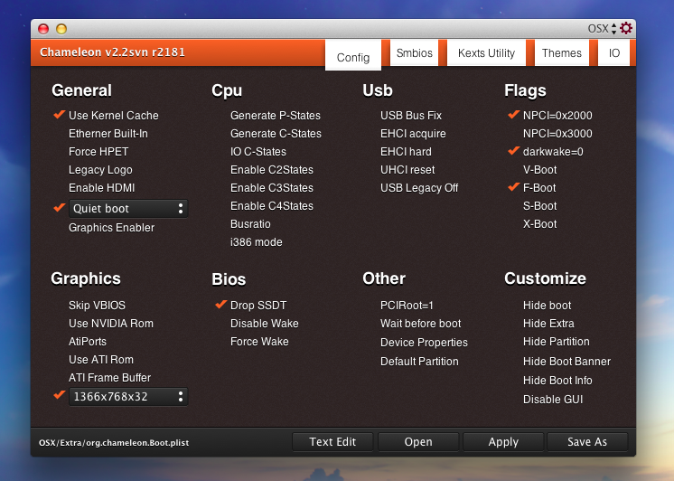

  • After Reboot, Open up Champlist (in your application folder) and select F-boot  Attached File  FBoot.png   252.23K   234 downloads

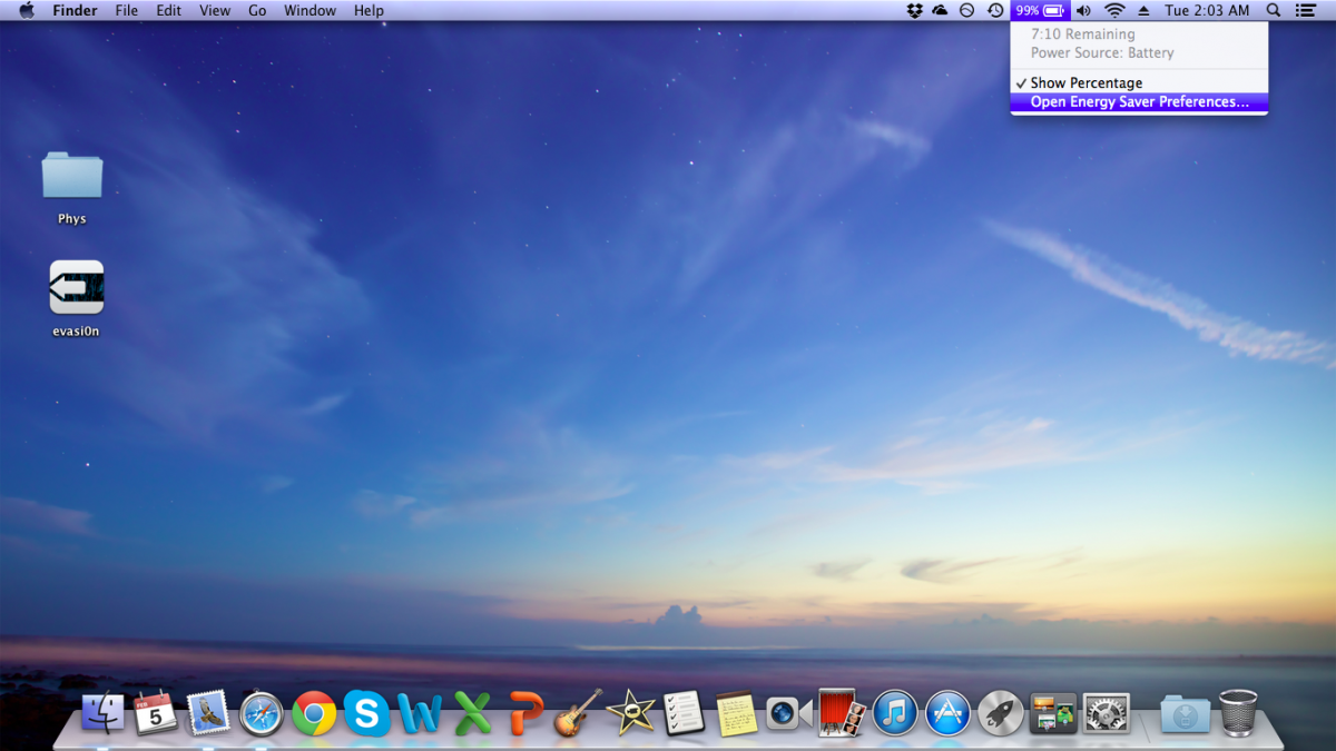

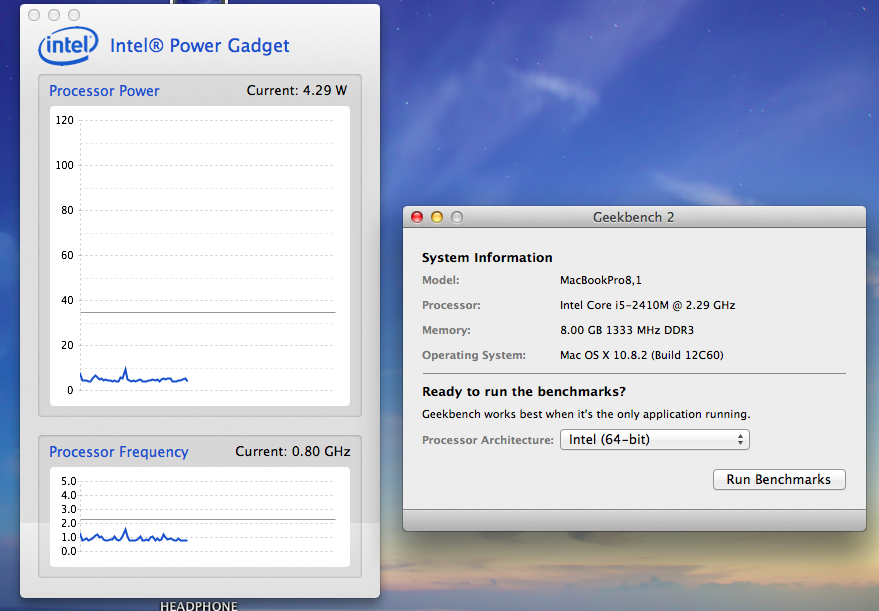

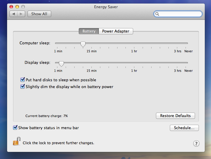

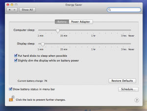

  • Set Graphics to Integrated instead of Switchable if you want to increase battery life (5 - 7 hr Integrated/2-3 hr Switchable)

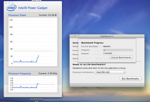

Attached File  BATT.png   794.58K   171 downloadsAttached File  BATT 2.png   123.82K   106 downloads

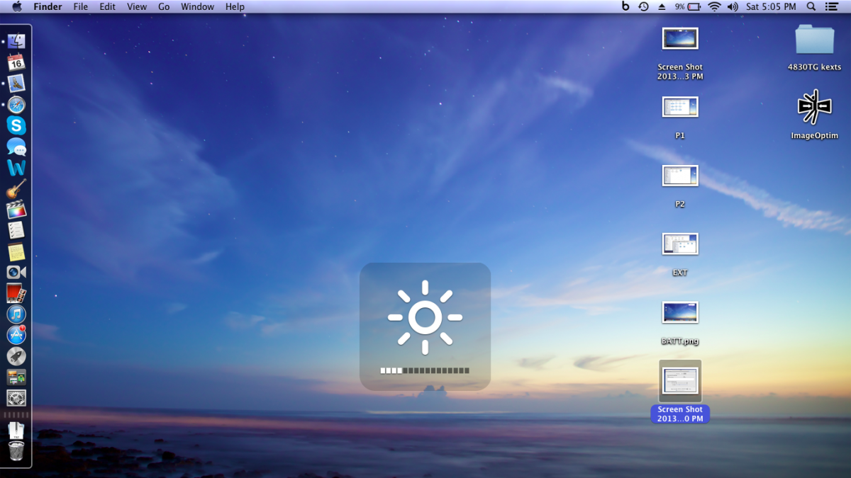

  • Screen Brightness Control: Fn + F12 (down) AND Fn + Pause (Up)
Attached File  BT C.png   115.81K   88 downloadsAttached File  BRG CNT.png   802.95K   103 downloads

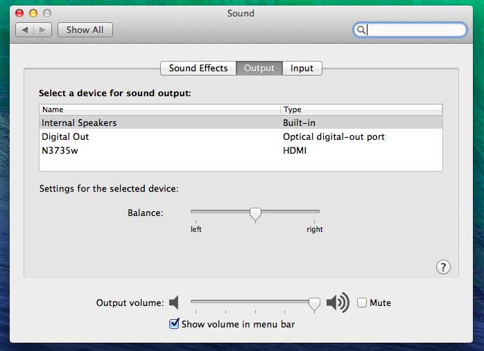

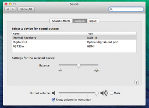

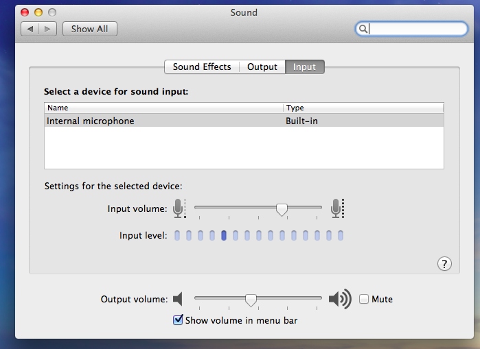

  • Headphone sound may be unstable at times (Open up Settings > sound > Mic and just leave the window open)
Attached File  HEADPHONE FIX.png   94.84K   108 downloadsTwitter: @rwu921

[UPDATE 4*] NO SLEEP FUNCTION IF YOU APPLY THIS KEXT (for now). USB 3.0 kext tested working!!! Here ya go fellows: https://mega.co.nz/#...ScGbwYryLNqYxVI
Attached File  Screen Shot 2013-03-29 at 1.55.51 AM.png   113.46K   69 downloads

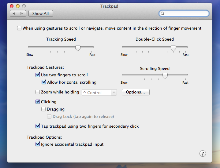

Just wondering, Before I install the Elan touchpad drivers, the os allows flawless tap-to-drag and works all with taps etc (no multi-touch) Then when I install the kext, I get multi-touch but cant tap-to-drag and any taps dont register, and clicks take about 3 secs to register :/ Any ideas?
#12
Yes, it is a trade off really. Personally, I would go for multi touch since it is more useful.
(The developer for this kext set it this way, there might be a value you could change in the plist)
Select everything except "zoom while holding" in the Trackpad under settings.

About battery issue, i've downloaded this kext ( http://www.osx86.net...ile&#38;id=3169) and works nice.
When i was using skype i noticed that my microphone don't works. Any solutions?
And i still have problem with booting without USBstick... I was trying with Win8 CD and by gparted in Ubuntu... and difference is that now i have "boot0: done"...
Except that everything works well and thanks for help.
I have never experienced mic issue on mine.
  • Open up skype>Preference>Audio/Video, you should see microphone settings. There should be only one choice (Built-in Microphone Internal mic).
  • Opening up Settings>Sounds>Input, and just leave the windows open (this fix is mainly for speaker not mic)
  • If still nothing, you need a new kext

Yesterday i've installed fix for iMessage and this kext for USB 3.0. And after that i have problems with wake up after sleep... I've trying to wake up notebook after sleep twice and every time i hear that disk and fan is working but notebook isn't wake...and i must reboot. And when i booting i see "Incorrect image signature". Except that osx run and works good.

hi,
my osx don't see battery too. how did you fix your problem? the link given above seems like down.

View Postmgmft, on 05 April 2013 - 05:46 AM, said:
hi,
Go to Settings>Energy Saver. Make sure "Show battery status in menu bar" is checked.
Tell me more about your computer and detail of your problems so i can troubleshoot.
All links have been tested working.
Yes, I was able to reproduce the issue. iMessage fix has nothing to do with it, it's all USB 3.0 kext's fault.
I am proactively looking for a fix, but in the mean time:
- Keep the kext, if you choose USB 3.0 function over sleep
- delete the kext, if you choose sleep over USB 3.0 (still able to charge devices)
