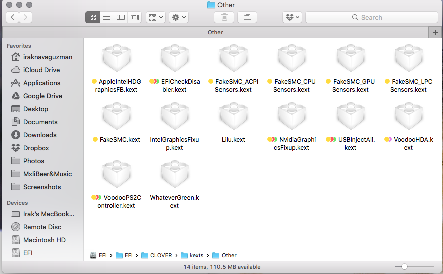

Test the configplist, copy the folder Other in place of yours, I have filtered the kext you need to your PC ...

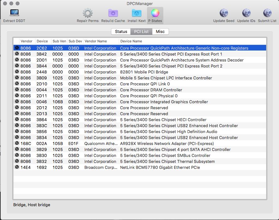

Post Photo DCPI manager
Test.zip

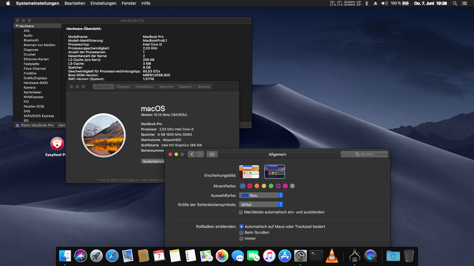

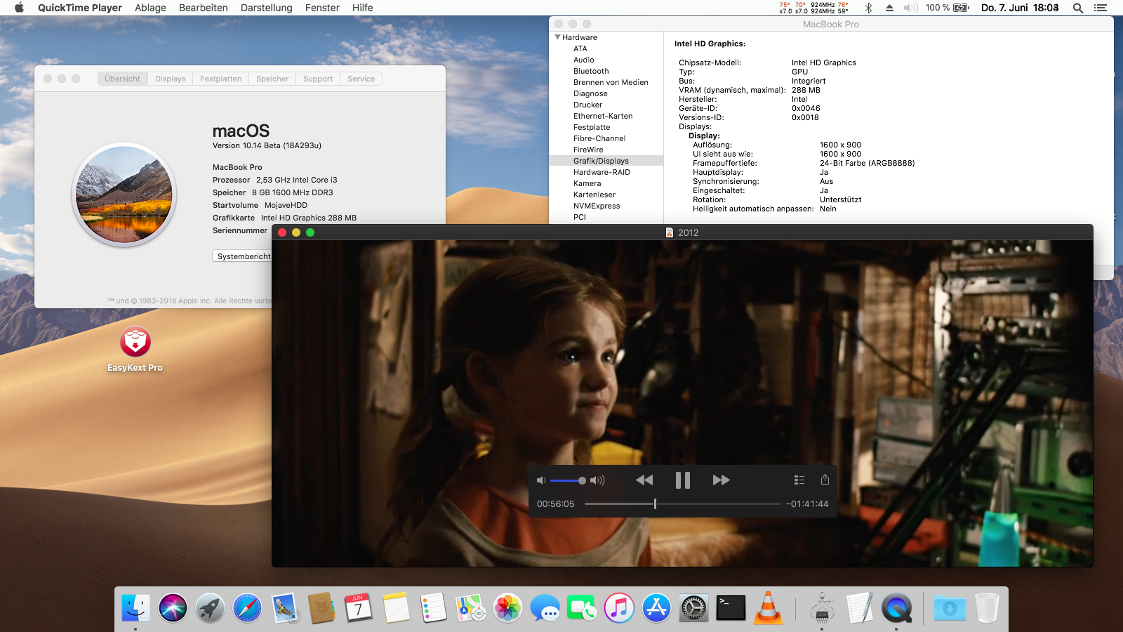

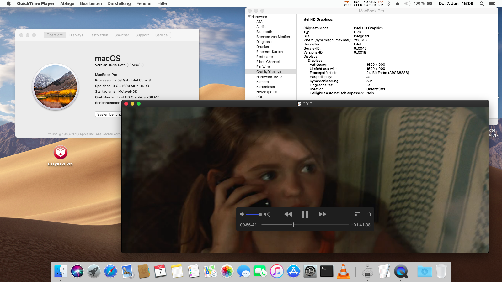

first attempt with Mojave and Intel HD Graphics 1.Gen :wub:
unsupported SMBIOS (here as MacBookPro6,1) with boot-flag "-no_compat_check" for unsupported SMBIOS / Mac's
Atheros WLAN is not working anymore (my AR5B95 does not work with Mojave anymore)
maybe with rollback, I want to try
Edit: Atheros WiFi works again with AirportAtheros4.0.kext to S/L/E
no transparent dock
Screensavers for example "Origami" and others work great
Launchpad without stuttering
Video and sound work very well here
DarkMode:
:thumbsup_anim:
Edited by MacPeet
  • Thanks 1
No, not a perfect acceleration
No transparent dock
Full resolution 1600x900 yes
Videos with QuickTimePlayer work well
actually everything works, only transparent dock is not

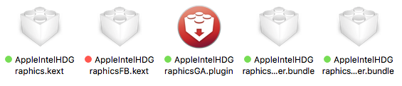

3 minutes ago, MacPeet said:
@Hervé
Unfortunately, Sleep / Wake is not working
I deleted my 5 IntelHD Kext's in S/L/E and put them after Clover /other.
Exactly the same result.
@cavallo
EFI Mounter v3 works with Mojave
EFI Mounter v3.zip
Thank you very much. I have always done the same, deleting all existing kexts restarts and install the right ones.

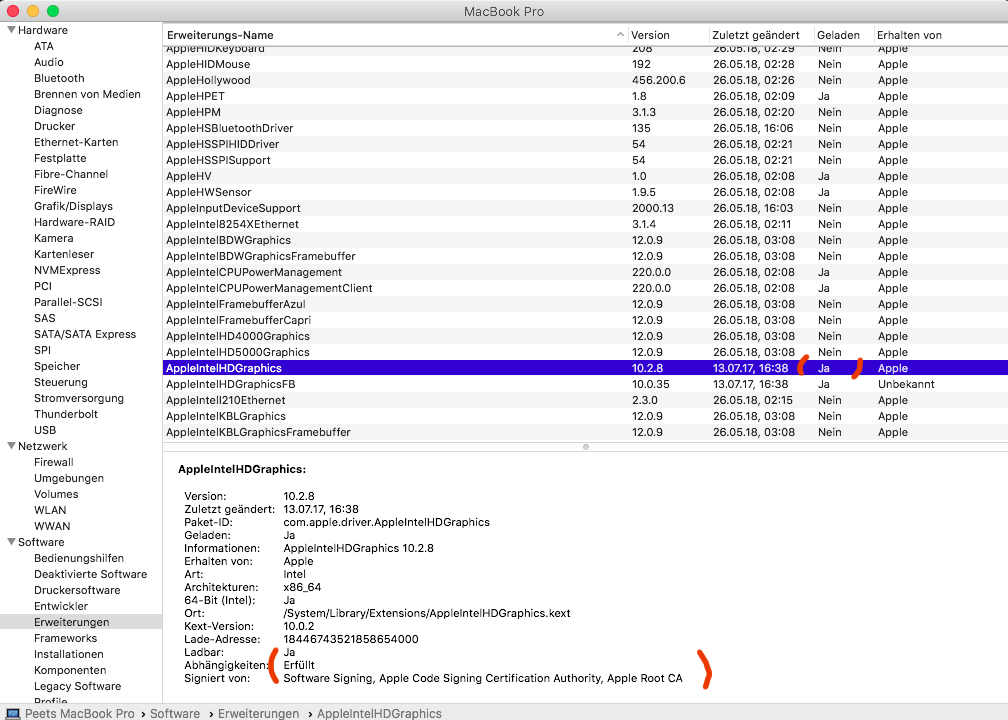

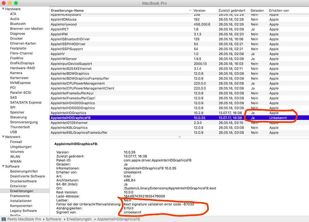

Fyi, my friend's 1st Gen. Intel HD Graphics is working fine with QE/CI enabled under macOS Mojave Beta 2 using patched AppleIntelHDGraphics*.kext from Sierra (16A323: 1st MAS Release). Have you tried with this?
More info!!! Special boot-flags?
For me, QE / CI does not work with Mojave.
My i3 380M is still working with the AppleIntelHDGraphicsFB.kext from Yosemite.
Duallink Alternate 2 1600x900 works very well up to HS.
IntelGraphicPatcher does not work for me. Maybe I'm too blond.
Mojave only without QE / CI here.
Wow... :thumbsup_anim:
I also have QE/CI with Mojave.
I have again installed my 5 patched Intel Kext's and IOAcceleratorFamily2.kext from the HS with KextUtility. Now QE / CI non metal works with unsupported SMBIOS MacBookPro 6.1.
Now everything works.
VLC, Youtube-Video's works
DVD player plays DVD's
... :thumbsup_anim:   :wub:
