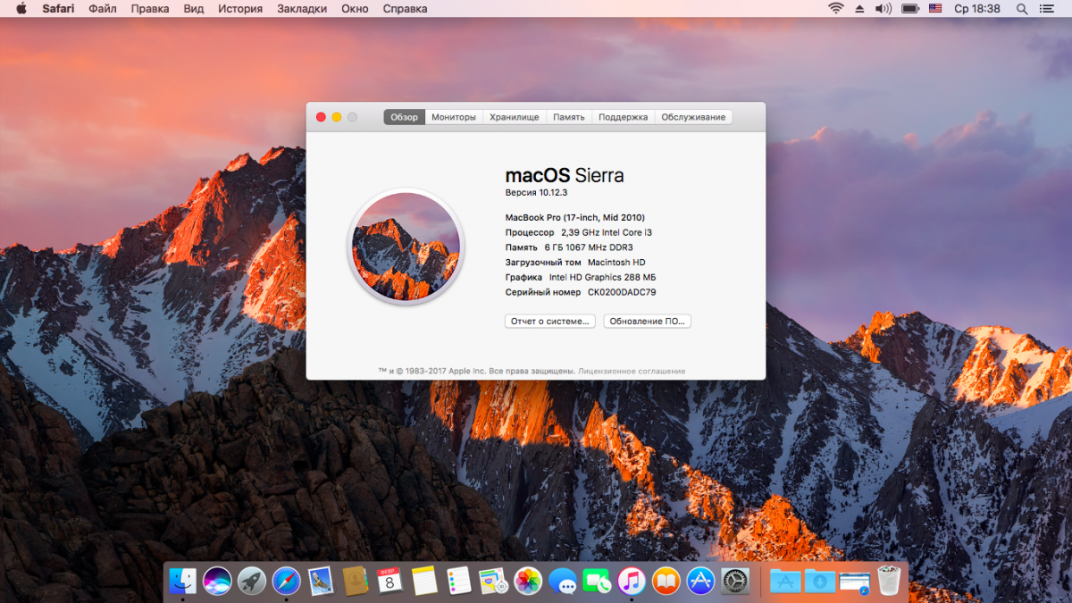

Confirmed working on Acer Aspire 4738-7664
Intel Core i3 M 370 2.4GHz
4GB RAM DDR3 1066MHz
Currently rocking 10.12.3 updated with Mac App Store like a real Mac

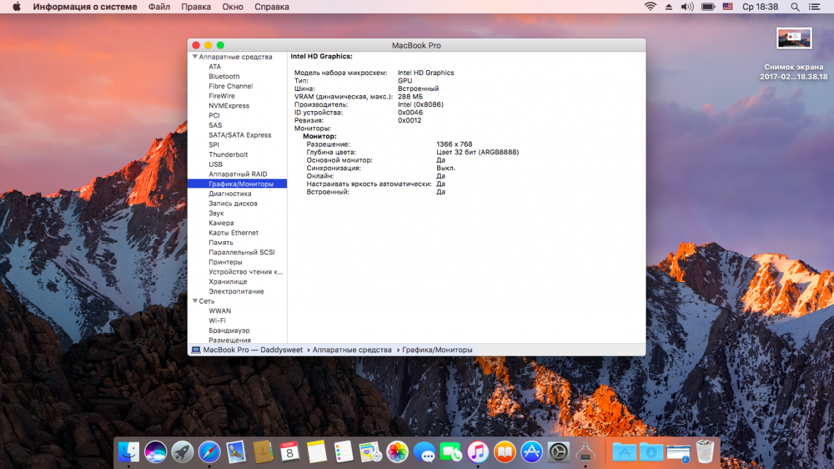

Hello everyone,
My species:
Acer Aspire 5742
Core-i3-370M
Installed macOS Sierra(10.12.3)
Vendor: Intel (0x8086)
  Device ID: 0x0046
  Revision ID: 0x0002
SMBIOS 6,1
I tryed everything (Intel graphics patch 10.12.3, Legacy-macOS, Normal-Alternative-Alternative-2, LW1-LW1) but everytime only scrambled screen.
In config.plist only Patch vBios is enabled.
Also tryed with Natit.kext but not succesfully.
Always scrambled screen.
Display don't show mac book pro, it shows apple screen 22 inch, why?
I patched dsdt.aml
What I need to do?
Please help!

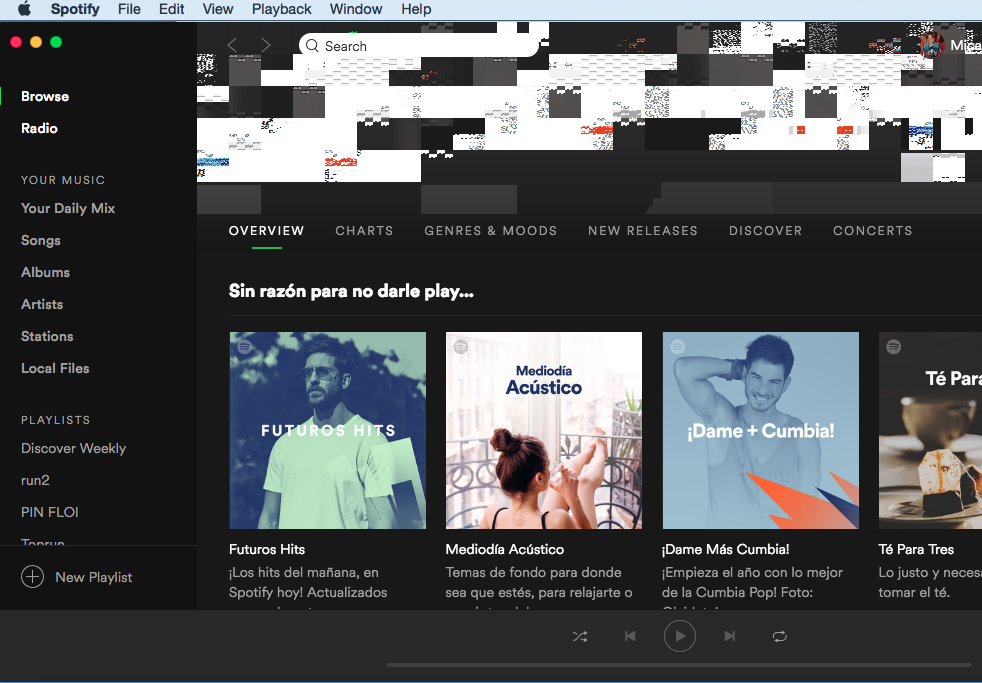

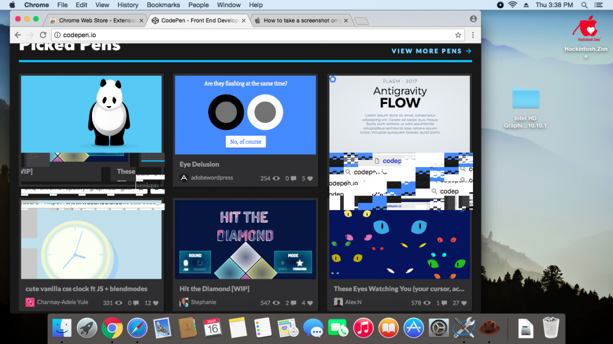

Hey guys! I'd appreciate your help with an issue I've been having:
After installing QE/CI kexts with Natit and getting everything working properly (full res + can watch HD videos on youtube) I'm getting some weird graphical glitches in apps like chrome (only some websites) and Spotify.
Has this happened to anyone / Does anyone know how to fix this?
Info:
Acer Inspire 5742
i5 480M
OSX 10.10.1 Yosemite
Framebuffer: Normal LW1
Can you post your config.plist?

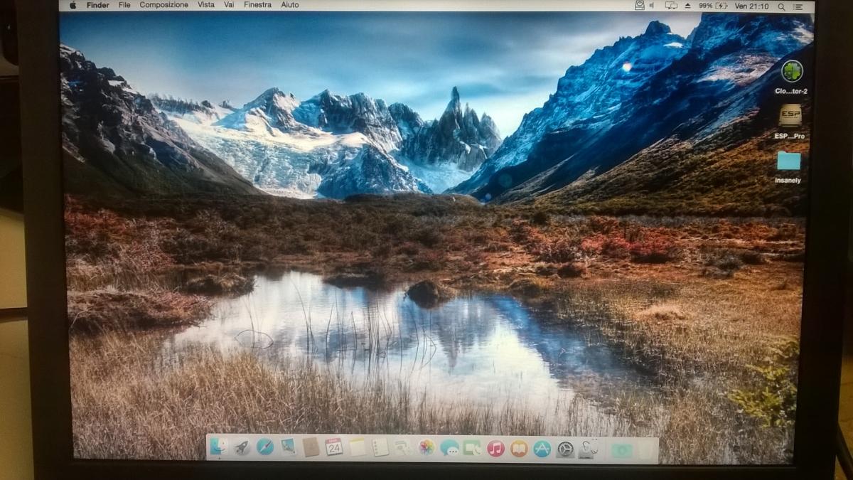

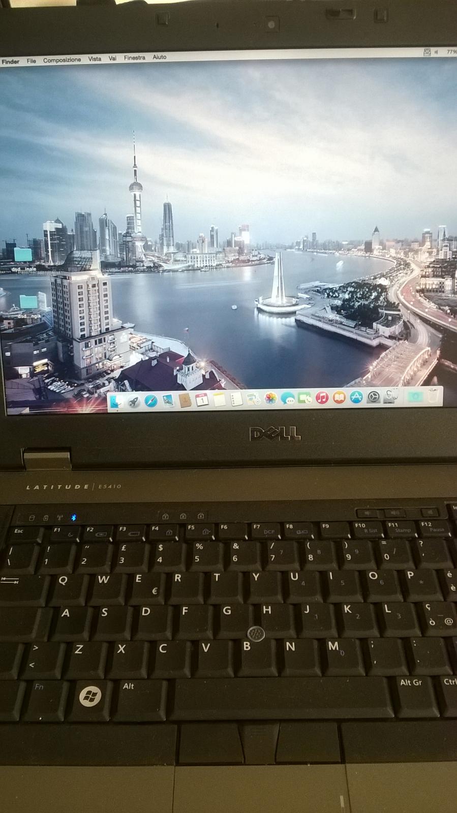

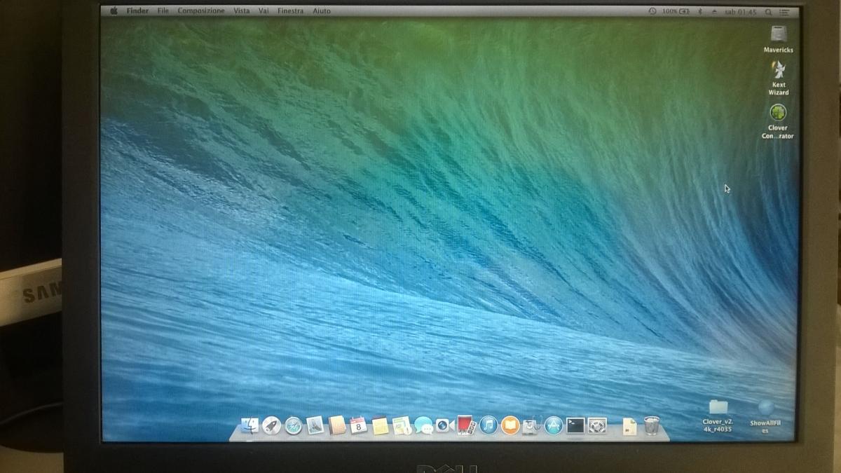

I've a Dell e5410 i5 560m, I've tried all the solution in this guide but now the notebook show full resolution 1440x900, no artefacts and no glitch, the only problem is that there's no Graphic's acceleration and a Mac without  QE/CI is not a great experience!
Any solution?
Dell e5410  i5 560M 4GB ram  Monitor 1440x900 HD Graphics 40 Hz
Yosemite 10.10 SMBIOS MacBookPro6,2
Any solution?
Who can help me, please? I tried everything, but without result. I have a sony vaio vpceb4b4e with intel i5-480m. Please, help me!
I believe both of your computers are not supported by the framebuffer. Sony computers never worked. Dells, only a few. It has something to do with how the display is connected, most likely eDP.
I've now successfully installed Mavericks with CI because if I read the guide, the only s.o. that can support CI for eDp connector end up to 10.9.5.
I've actually partial acceleration with full resolution and I sure know that this is the best for my kind of Dell, Better than nothing!
P.s. Thanks for reply Ghost rider and if I can, just one point to modify in your guide:
For enter sudo intel_reg_dumper you have to use actually Linux Ubuntu based distribution 12.04 or below, with updates Linux distros intel_reg_dumper tool don't work, so in live there's no possibility to launch the command.Bye
