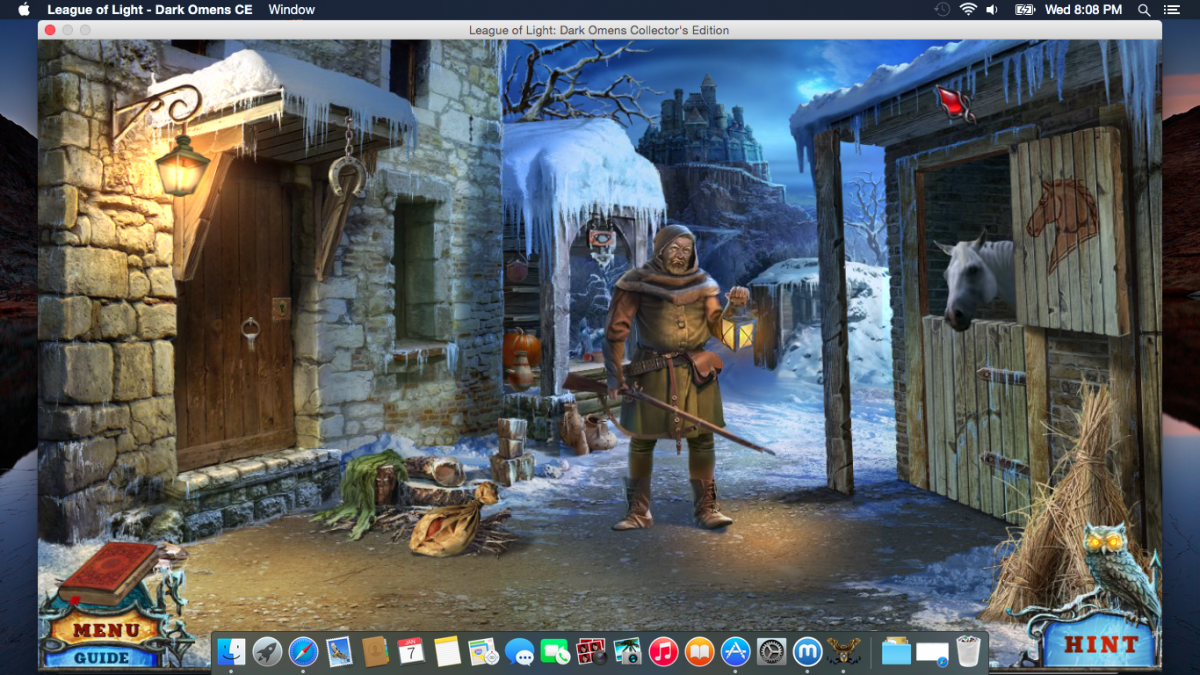

rizki_alkaf
Download this demo:
from MacGameStore
League of LightL Dark Omens
tell me if this is playable on your side.
This is OK on my gateway.
I did recompile, sceneKit with 10.10 sdk Target 10.8 (most common on new games)
and passed 2 test.
Did Apply some crazy theory of mine.
It's an 850 MB trial game. Quite large download file for just a test. Sorry, i'm a cheap guy, with a slow, non-unlimited internet here

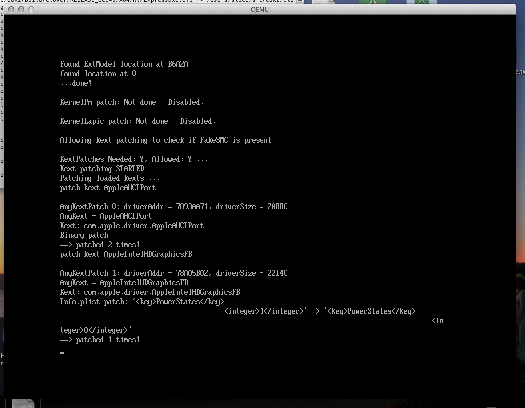

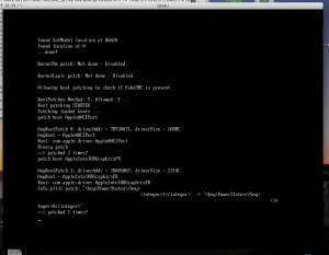

Test, please
		<key>KextsToPatch</key>
		<array>
			<dict>
				<key>Comment</key>
				<string>Power state 1 - 0</string>
				<key>Name</key>
				<string>AppleIntelHDGraphicsFB</string>
				<key>InfoPlistPatch</key>
				<true/>
				<key>Find</key>
				<string><key>PowerStates</key>
				<integer>1</integer></string>
				<key>Replace</key>
				<integer>0</integer></string>
			</dict>
		</array>
CLOVERX64.efi-3127.zip
Hey Slice, so I noticed that the infoplist patch code you posted only works on this Clover X64 (3127) release. I tried it on an older version of Clover and it doesn't work. Its no problem.
The good news is that it appears that Clover has found the string and then it successfully patches it. But there is a problem.
Sadly, the infoplist patch doesn't actually patch it. My computer freezes during boot when PowerStates is set to 1, so either the infoplist patch isn't working or the code being written to memory is not correct. I did notice that it adds a space when it patches it as seen in the screenshot. I'm not sure if thats a problem.
If I modify the kext to have power states = 0, the computer boots correctly with the other kext patches.
Is there a way to check if the infoplist patch is actually working in this type of situation? For example, I can change "Watermarks" from 1 to 0 and it won't affect my computer when it boots. But once I boot into the desktop, I would like to see if this value actually changed correctly. Not sure if its possible.
