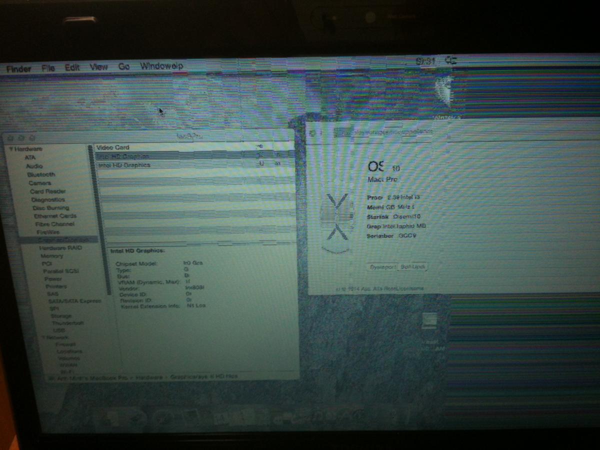

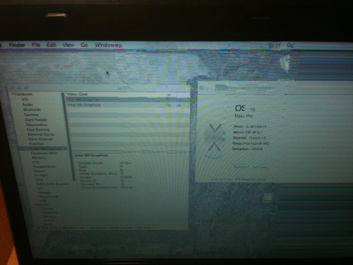

Installed Mountain Lion. The Kext work I got CI enabled.
Installed Mavericks. The Kext from 10.9.3 don't work. Got a distorted screen....
Any ideas???
Install Natit, maybe it help...

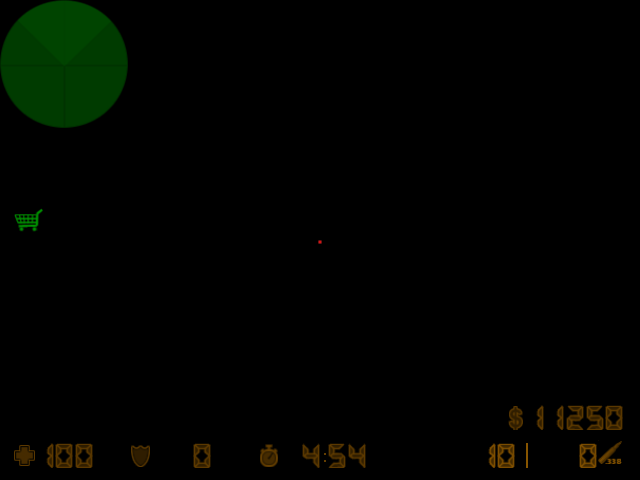

I've a question... (or a problem)
When i'm playing Counter-strike 1.6 (very old game), when i zoom AWP, my screen go Black.
I'm posting a screenshot to show better...
I've tried Counter-strike 1.6 STEAM and No Steam and the problem still  :(
Any ideas???
Weird, should work fine. All you need is the AppleIntelHDGraphics.kext, AppleIntelHDGraphicsGL.bundle and AppleIntelHDGraphicsVA.bundle. Make sure that if you are using Clover, disable Intel injection. Maybe you have wrong Intel graphics igpu? to little information
Same thing as said above. OS X and the Intel HD Graphics IGPU probably have bugs when it comes to games. If you really need to play games, dual boot Windows. Besides games on Windows perform better than OS X for some reason.
If you are wondering why the Intel HD Graphics IGPU has bugs, its because Apple never intended people to use the IGPU for games. In a real MacBook Pro with Arrandale processors, they switch to the NVIDIA GPU. Apple probably didn't want to spend time fixing this anyway. Not sure if this is fixed in OS X Yosemite.

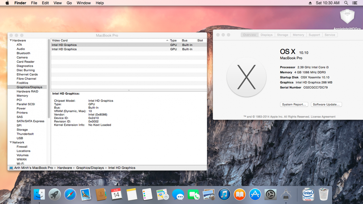

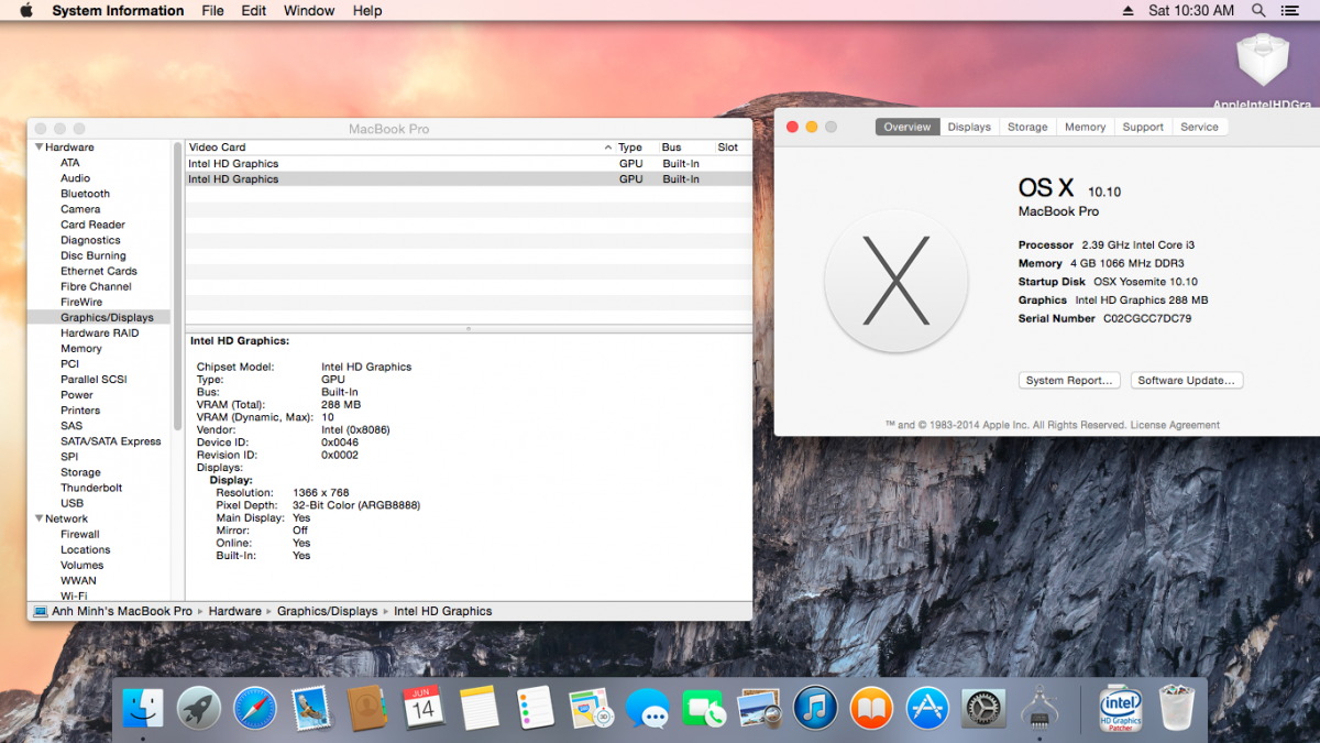

for me it's working without problem..
Screen%20Shot%202014-06-18%20at%2011.59.

I have the intel (8086) Device 0046 (i3 380M)
I installed mountain lion n hard disk (works fine)  and to test mavericks on a USB disk. Clover boot is install on the USB disk too. Copied the clover configuration from Mountain Lion to the USB disk with mavericks.  So clover configuration is same for ML and Mavericks.
Installed the CI 10.9.3 with kext utility for mavericks....
Is the kext utility maybe causing this problem. Which kext installer do you use for mavericks?
I use Kext Utility as well. I'm not sure what's going on. What if you install 10.9.2 or earlier versions of the CI kexts? If its the same result, I believe maybe Clover is doing something unless you have the AppleIntelHDGraphicsGA kext somewhere hidden in the Extensions folder. Check thourougly that Intel injection is disabled in Clover and make sure that AppleIntelHDGraphicsGA is nowhere to be found. Not in Clover folders nor in Extensions folder.
