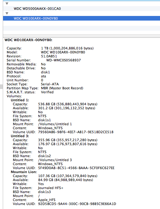

Hello,
I have just installed my first hackintosh and everything works perfect except that my sata disks are working in ata mode as in the picture
Can you please help me?

Use AHCIPortInjector.kext

How gino I,ve got it in my ale along ahc1 extended injector and it is still the same.

Sorry to hear that, it has IDs for ICH7 so I assumed it would work.
Note that there were several versions of the ICH7, only the ICH7R, ICH7DH, ICH7-M and ICH7-M DH have AHCI support. Plain vanilla ICH7 does not have AHCI support.
