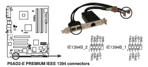

I'm building my first Hackintosh with this Quo mobo purchased 3 weeks ago. I took a Be Quiet Silent Base 800 case, a Corsair RM 750 power unit, an I7 3770 (not k), 2 X 8go G skill Ripjaws ram , a Thermalright CPU fan, a Radeon Sapphire HD 7950 with the bios flashed as Mac Edition, 2 X SSd Micron 256 Go: one cloned from my MacPro rev 5.1 with Yosemite, the other with Win 8, and a broadcom BCM94360 CD Wifi/Bt4.0 PCI card . For the FW 800 headers, I found an Asus P5AD2 bracket with two IEEE 1394B ports and RJ45 without use here.
It works great with sound, wifi, BT, HDMI, the only one problem was when the plastic slot of the 16 X PCI  socket went off with the graphic card when I took it out... I got a new slot on ebay, and I'll fix this problem later: 164 pins to sold on the mobo is not a funny passtime. I put the GPU in the 8X slot, and I'm not sure to see any difference with 16X ?

The card has two Firewire IEEE 1394b ports and one LAN connector RJ45 bracket provided for a ten years old Asus P5AD2 mobo. Got it on  the bay from a seller is  in Carlsbad calif. I didn't need the PJ45 bracket, so it's easy to unscrew it. I had not the occasion to use it yet, but I'll test the assy. tomorrow with a camcorder and Imovie. Anyway, it fits perfectly in place, you just have tu plug the 2 purple connectors in  the 2 headers , assuming that Assus and Gygabyte respect the ISO headers configuration: I'll have to check this point  first....
Is there a part number on the card ?
attachicon.gif No. No part number. I just found it was part of the  ASUS P5AD2 premium bundle, the left top one.
Man, I love you! I had that exact same board and have the left-over connectors and never even occurred to me to go and check! :) Thank you a lot! :)
