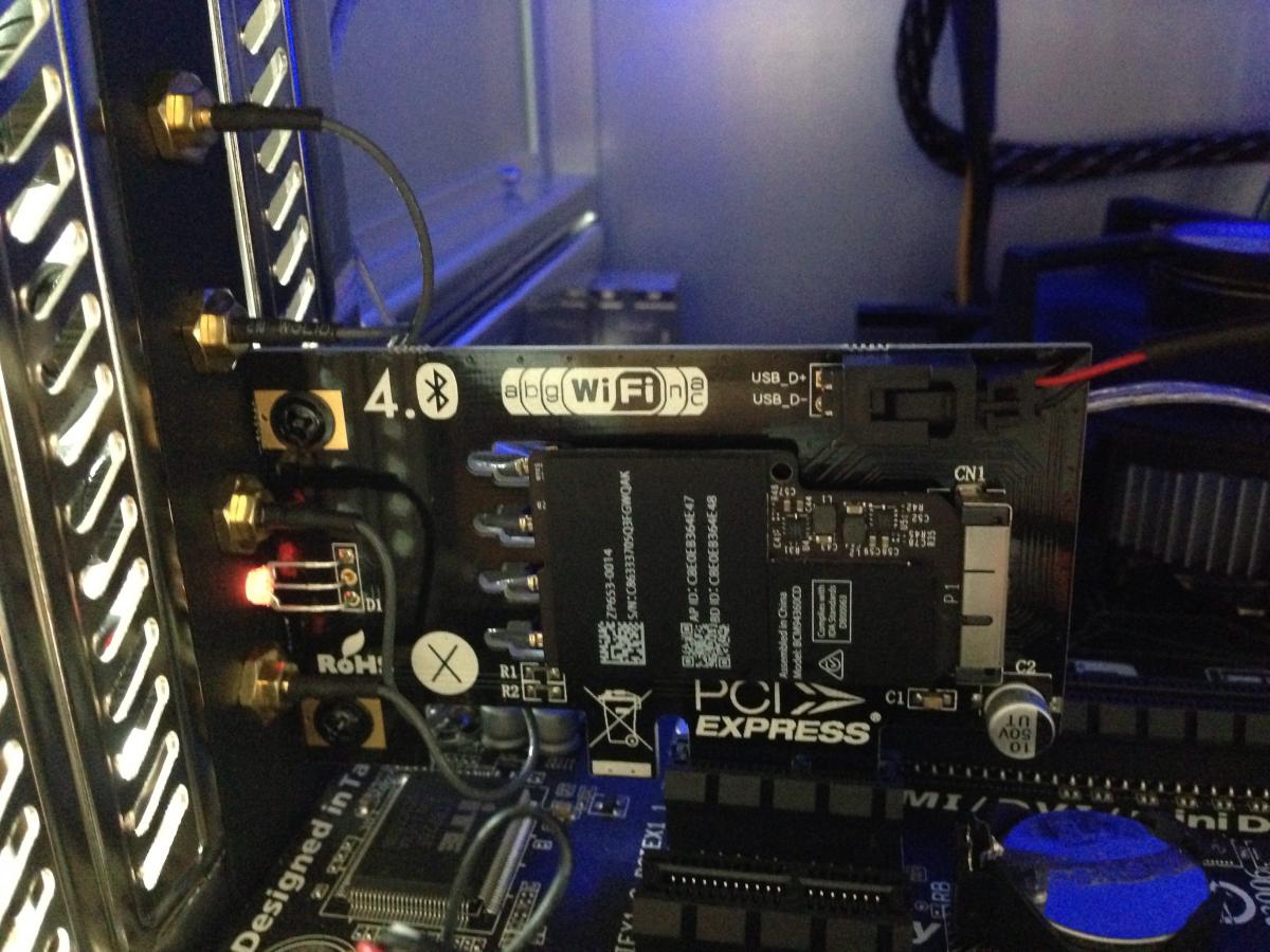

recently ordered one of these
http://www.ebay.co.uk/itm/131343121358?_trksid=p2059210.m2749.l2649&ssPageName=STRK%3AMEBIDX%3AIT
And these.
http://www.ebay.co.uk/itm/201204735311?_trksid=p2059210.m2749.l2649&ssPageName=STRK%3AMEBIDX%3AIT
Should have native bluetooth & AC wifi speed.
Using natively supported bluetooth etc cut's out allot of issues.
Lemme know how it works once you have it .. it looks pretty interesting

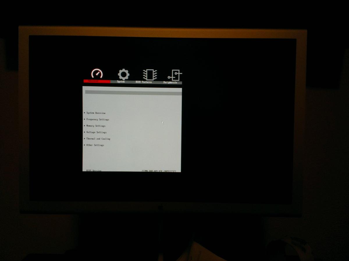

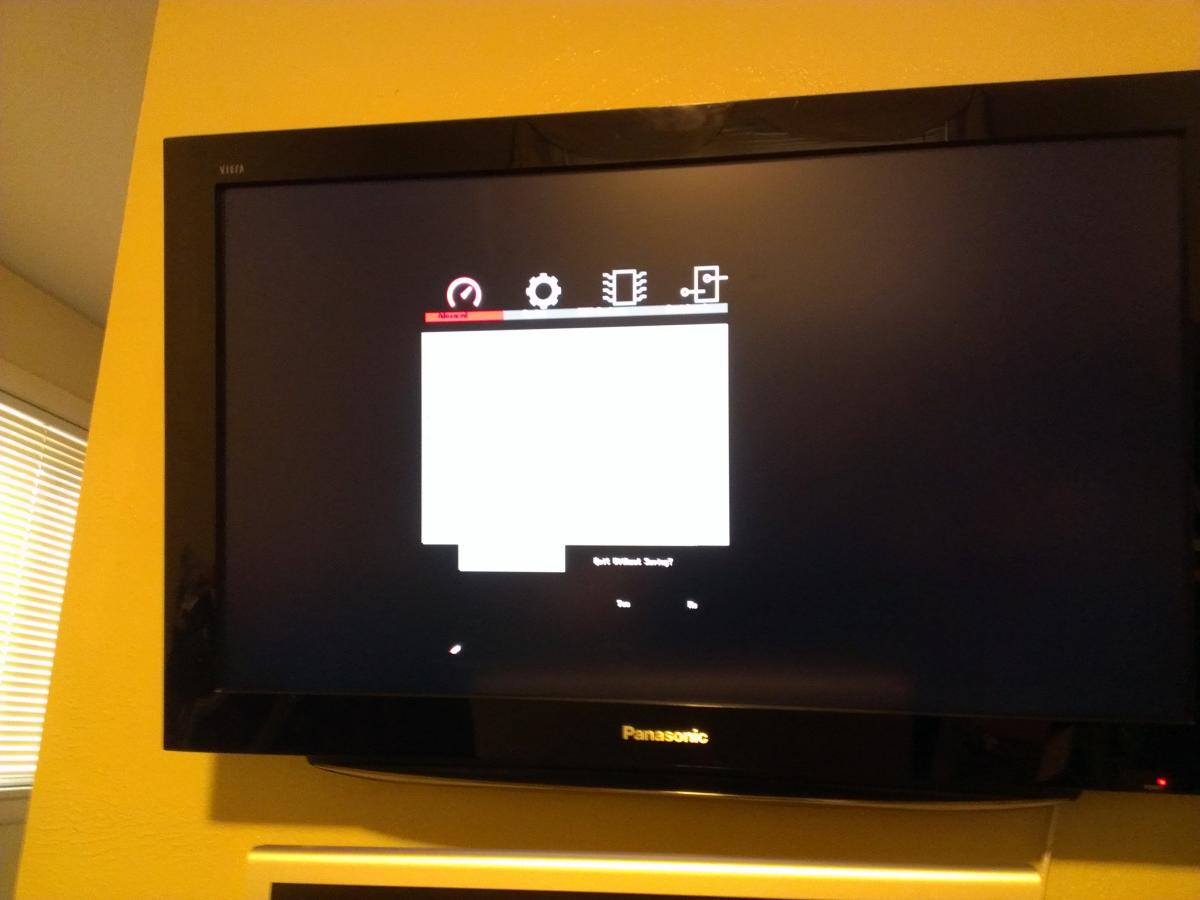

Anybody else have GUI issues with H3C 1479?
When I access the BIOS, Q-flash, etc. the GUI is out of alignment from what appears to be a possible mismatched screen resolution. This happens with my 20" aluminum cinema display over dvi as well as my tv over mini displayport and hdmi. CPU: i5-3475S with integrated HD4000.
Stock and 894M do not have this issue. Navigating the screens is impossible at this point. I was able to get back to 894M through trial and error in q-flash.
Take out the TV, go to BIOS Features/Display Boot Option ROM Control and set to UEFI First or UEFI Only.
CsmVideo has trouble to handle multi-monitor setup, it should fall back to standard resolution but in your particular case seems is not...
No luck. I should also mention that this happened before attaching the second display. Thank you for your suggestion, hopefully I can figure it out.
Then the problem is the ADC, use instead the TV connection to go to BIOS(remove ADC) setup to UEFI OpRom and pray...
I just received mine and... it works perfectly!  No drivers needed, it's recognized as native (apple) hardware.
This means bluetooth 4 and wifi with airdrop, handoff, instant hotspot, etc. all that new things coming with Yosemite fully enabled. I'm just doing some tests but all of them seem to work smoothly.
That's great to know.

-Some firmware won't enable displayport during bios. Need to move TV just to edit bios.
