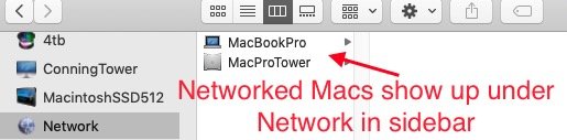

Here's a weird one.
In the Finder you can choose to view networked volumes in the sidebar (turn it on in Finder Prefs  -> Sidebar -> Locations -> Connected Servers).
On my MacBook Pro, it works what I consider to be normally -- the other Macs on my network that have sharing turned on show up individually in the sidebar of the Finder as something I can click on and mount. As you can see, the Finder sidebar shows both the Network and the two other Macs on the network.
View from laptop

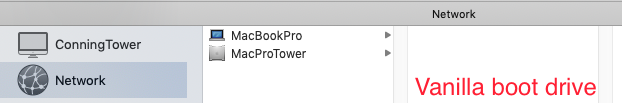

Another thing that has me puzzled is the reference boot drive also does not show the actual volumes in the sidebar, just the Network link. That is different behaviour from the laptop.
View from vanilla boot

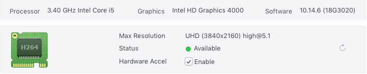

I made progress (firmware & config)  ....more to come...
Spoiler
Issues:
Not reading fan sensors ...  Fixed HW Monitor is not compatible with VirtualSMC using HWMonitorSMC read sensors correctly
Black screen on cold boot in Mojave 10.14.6 Worked around the issue
Tested : Mojave
Tested : Catalina
Tested : Windows 10
Issue : Reboots when waking from sleep under Mojave
Tested : Sleep/Wake  under Catalina
Tested : Recovery mode for Mojave and Catalina
Tested : iCloud, iMessage,AppStore .. no issues.
Tested : HD4000 in headless mode for H.264 hardware acceleration

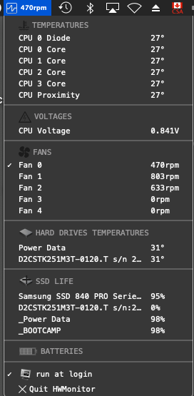

3. Fans/Cooling. The Quo idles with a CPU temperature of 71°C, and the fans run pretty loud. I'd like to be able to finesse them. But there's one weird thing: iStat Menus, smcFanControl, TG Pro, HWMonitor, HWMonitorSMC2 etc. all list more fans than I have:
• CPU Fan
• Power Fan
* System Fan
* System Fan
* System Fan
Depending on the software, I can control the speed of the fans, but it's disconcerting to have fans listed that I don't have. And it's wearying to have what sounds like a small jet engine running full time under my desk.
Q: How can I tell the OS that the correct list of fans the Quo has? And is there a preferred software for controlling fan speed?
• CPU Fan
• Power Fan
* System Fan
* System Fan
* System Fan
Number of fans. The only software that will give you only the fans we have is HWSensors if and only if you are also using the SMC sensors built into the firmware. If you have FakeSMC in anywhere or VirtualSMC .. it will list additional fans because they don't have a profile for the motherboard.  This is something I might want to try to do for OpenCore (make a QUO motherboard profile to include for VitualSMC).
Unless your fans are Spectre Pro PWM (your sig says Spectre Pro ..which means regular) there is nothing to control. Set them in firmware - choose Silent).
The Intel stock CPU cooler sucks a lot, if you do any kind of very cpu extensive work.. I suggest you get a decent cooler else the CPU have have to throttle down to prevent it from reaching too high temperatures.  71C @ idle is a lot .....you did put the thermal paste right ? Here r my temps and rpms...

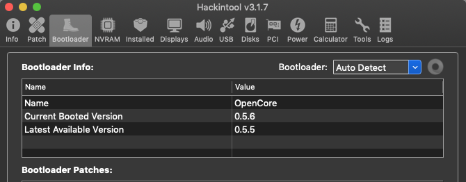

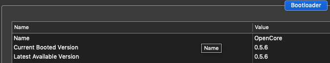

On 3/5/2020 at 9:43 PM, IronManJFF said:
Update...this is where I am at concerning OpenCore.
Sorry not moving fast .. running a few projects at same time.
Issues:
Tested : Mojave
Tested : Catalina
Tested : Windows 10
Issue : Reboots/KP when waking from sleep under Mojave YMMV seems to occurs only when I force sleep it
