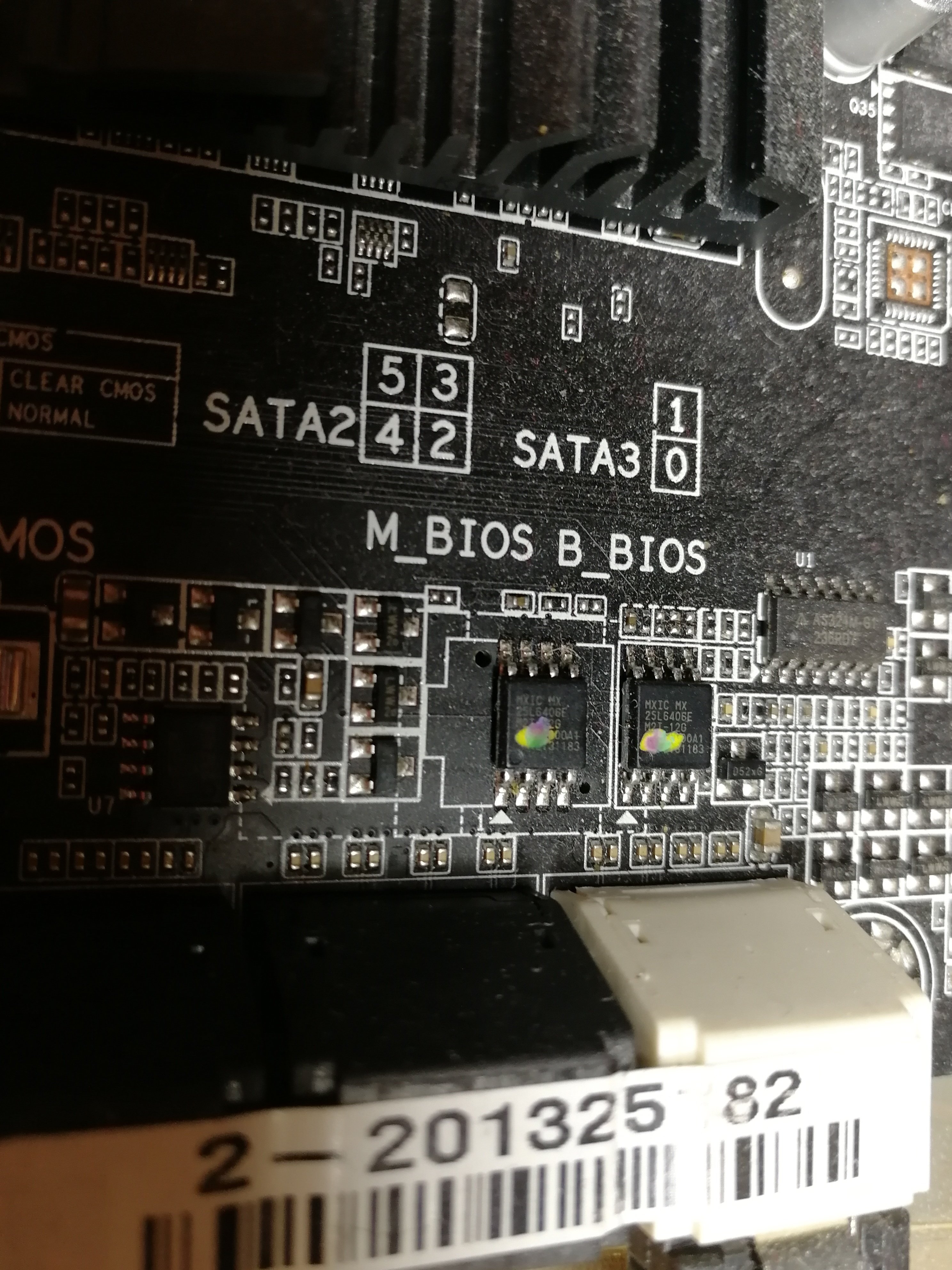

Does anyone know what bios chip it is theres a drop of paint on a part of it so I cannot see. I am going to try to fix it again got a hot air gun for soldering now just cannot read what it say on the chip.
Edited by Nubira

I found a couple of chip myself too that looked the same but the two last lines of text are hidden behind that paint so you cannot tell if its the right one. Maybe its a chip from one "family" so they all would work though. I´ve seen reports on a way I never tried to get the backup bios to kick in so I´m gonna try that first. They say if you loop/hold a metal wire between pin 1 and pin 6 and do some other stuff I forgot now (was late last night) the backup bios might kick in.
Maybe I´ll do a youtube livestream to this thread when I work with it.

Oh I did that many times but it does not work on this mobo so that´s why i´m gonna try this third method I found.
Method 3, which explains to short/jump/bridge pins 1 and 6 on the M_BIOS chip to kick off a routine installed in firmware which reflashes a corrupt M_BIOS with the contents of B_BIOS, worked wonders for me, for which I'd like to thank the OP.
I had eliminated all possibilities other than the motherboard, and was about to RMA the board (which entails hefty shipping charges not to mention losing the board for a few weeks) when I discovered this thread and got Method 3 to work when nothing else would.
HOWEVER … at first I couldn't get it to work, despite trying a handful of times. What finally did it for me was when I stopped paying attention to the specific instruction of letting go of the pins when the power ON single beep is heard : on my board (a GA-H97-D3H) I had to KEEP HOLDING THE TWO PINS FOR 5–10 SECONDS after the initial beep before being rewarded with this pop-up message on my display :

It may depend on the board, or maybe if the OP sees this he might know why … but if you have a dual BIOS board and method 3 didn't work for you and you're out of options, try it again but keep holding pins 1 and 6 with a steady hand for at least ten seconds after the initial beep, see if that doesn't do it for you. Did for me.
If Method 1 and 2 doesn't work to kick in the Backup Firmware, it's easier to short Pins 5 and 6. You can do this with a screwdriver or a paperclip cause the Pins are next to each other.
