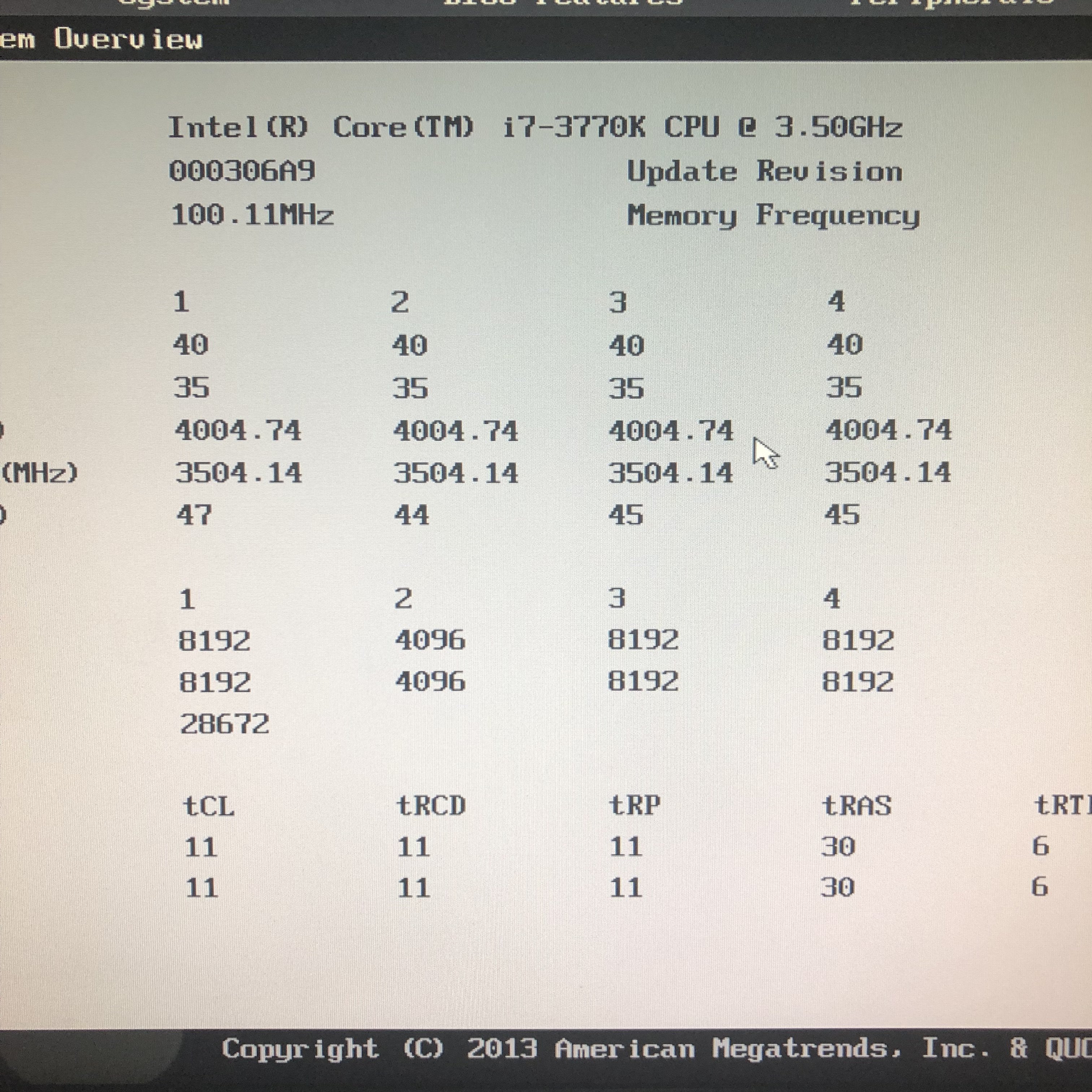

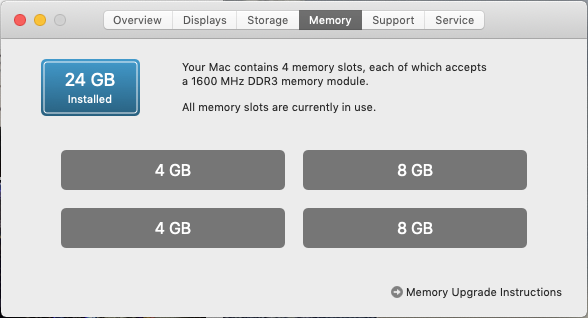

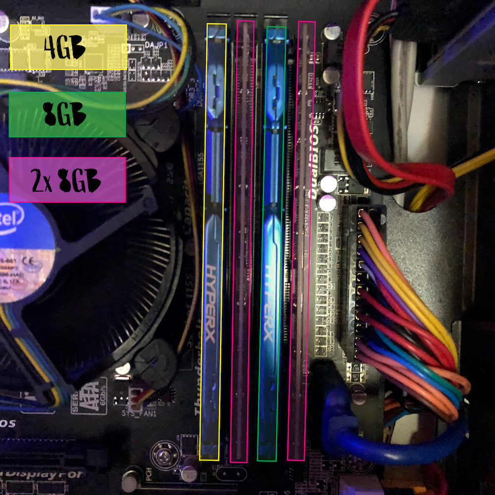

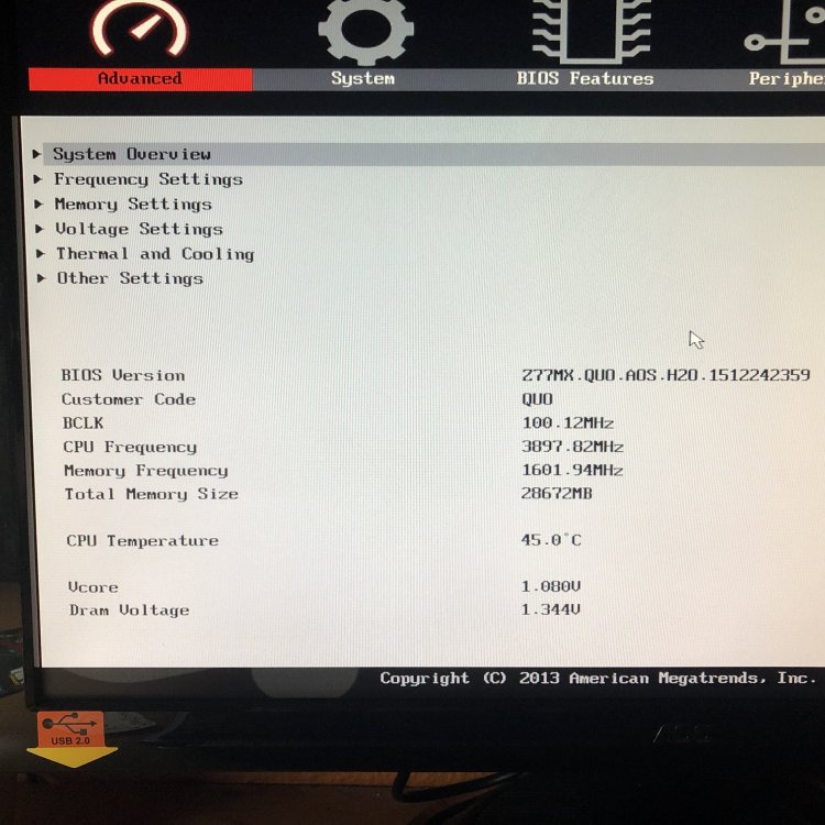

Hello everyone, I need some help again :yes:
This time at least it's not a life and death situation at least.
Ive had the chance to slightly upgrade my RAM with an extra pair of 8GB sticks, but now they are not recognised correctly by macOS so it seams, as it should be 3 sticks of 8GB and one of 4....
Even though they are detected correctly in the BIOS: :huh:
And here they are on the board: Socket one and two have 8GB Crucial RAM, socket 3 has 8GB Kingston hyperX fury and socket 4 has 4GB Kingston hyperX fury:
Has anyone had this problem before? At first I thought it might be damaged memory channels on the processor, or bad RAM, but as all of it is showing in the BIOS, I'm not too sure.
It's not Crucial (see what I did there?? :hysterical:) for me to get it running all the RAM, but it would definitely be nice...
As always, thanks in advanced, and any help would be much appreciated.
Live long and prosper friends! :startreck:

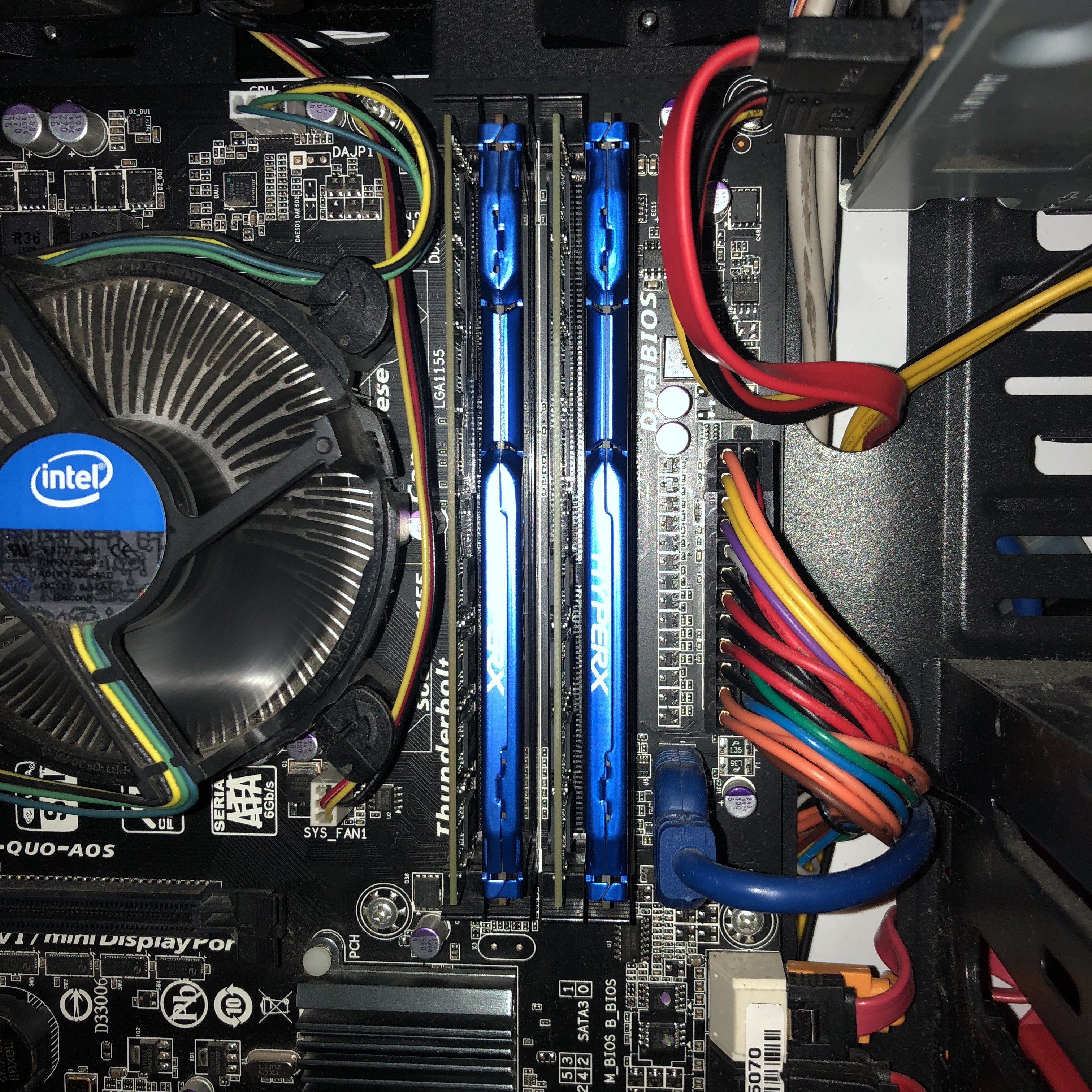

Ok, so I swapped the RAM around, but the problem persists, I also reset the BIOS to defaults, and simply enabled the virtulization setting because I need it for my virtual machines.

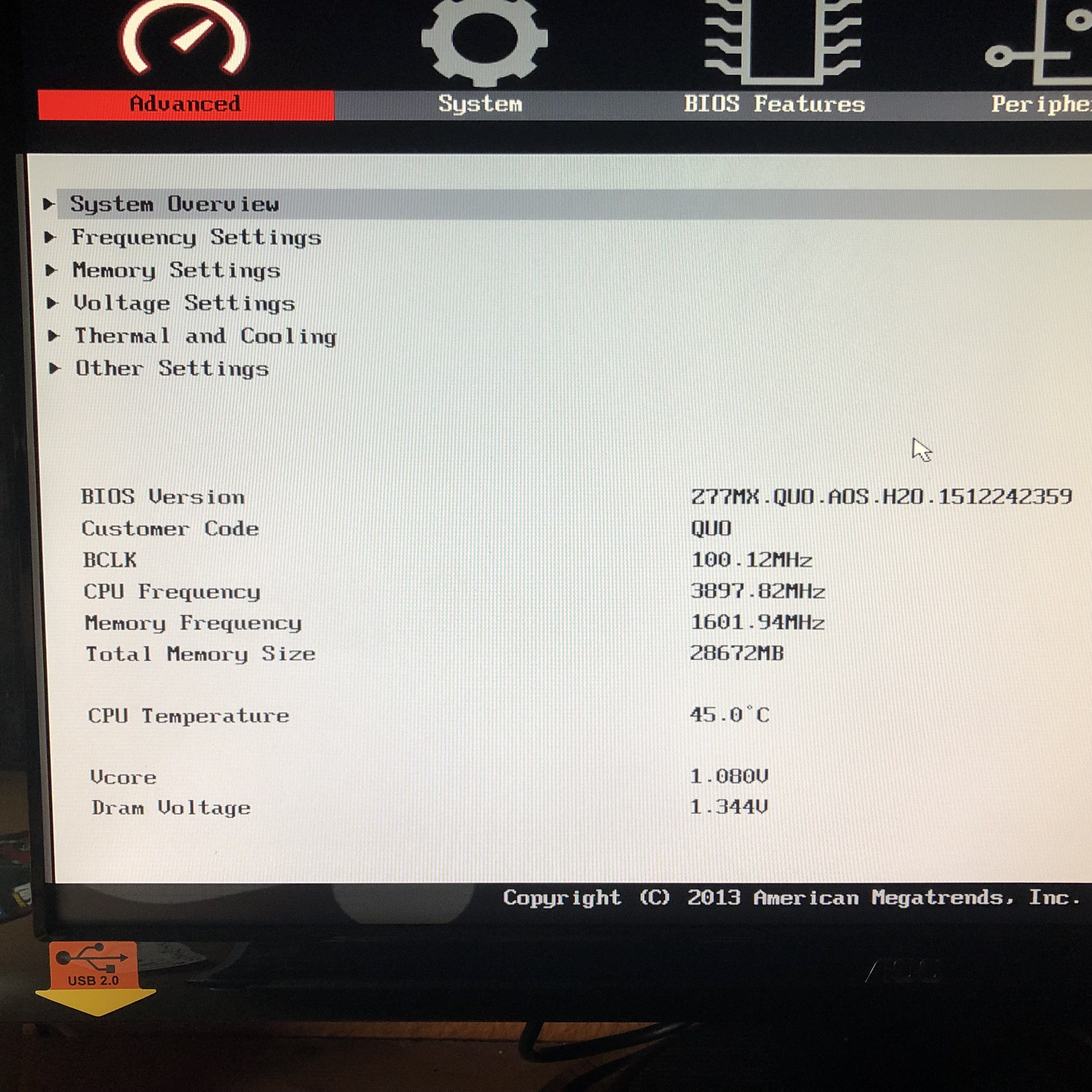

So at the moment everything is running as stock.
This is the current layout, and as you can see, everything is being detected...
Which is equal to this: (from left to right) Crucial 8GB, Kingston 4GB, Crucial 8GB, and Kingston 8GB.
I have no idea why this isn't working, could it be due to damaged memory channels ?

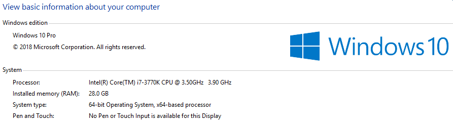

UPDATE: it seems to be something with MacOS as Ive plugged-in a windows 10 drive ad it has detected the full 28GB of RAM, this is slightly getting on my nerves now XD.
UPDATE 2: ok, sorted it, it was kind of a stupid fix really. The solution came from the official apple support site, where someone's Mac had a problem registering new RAM, so they suggested resetting the PRAM, so I reset the NVRAM, and it seems to have worked. :yes:
