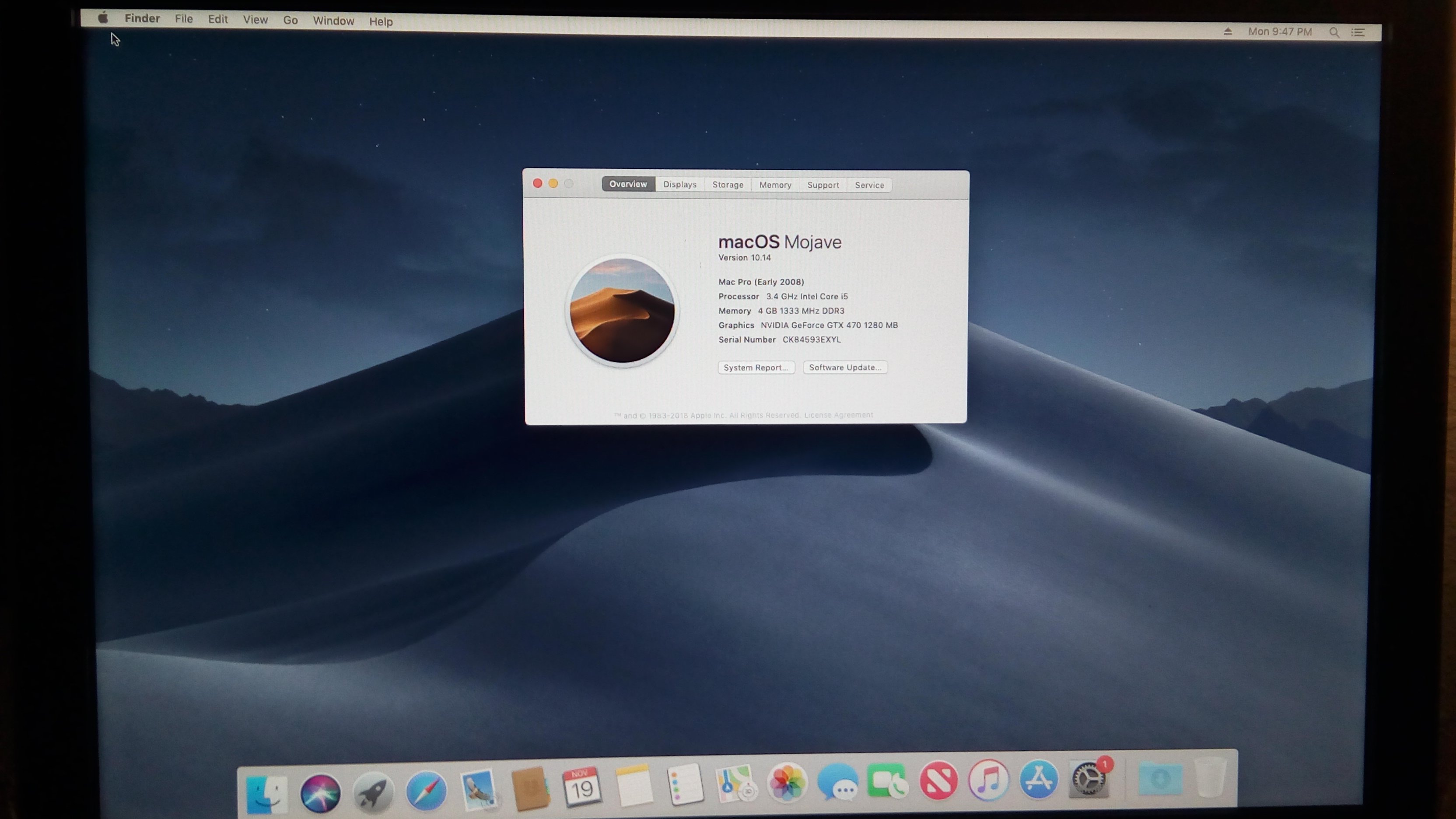

On 11/16/2018 at 4:00 PM, tlogan23 said:
Ok did that, now I don't get an imediate
Ok now I don't get an immediate stop sign, but it just sits there after I select and installer. USB light is flashing, but I my screen is showing the boot selector screen. Thank you for your help! tim
Not sure why, but for some reason it only now accepted my 4 finger salute. So the dmpstore for the bios date and version now match nvram. Booting from the Mohave USB installer, seems to hang at HID: Legacy shim 2 and then the screen locks with a funky look. I am going to try to us my Zotac Video card (GTX470) and see if I can get farther. Thank you for all the help IronManJFF
29 minutes ago, tlogan23 said:
I am on too many forums. I've updated my signature. :-)
found that this error can be related to the USB port, so I used a different port (on back). Looks like it worked, waiting for the system to come up after the reboot from installer. not sure how Mohave will behave with my GTX470, but I will soon find out.
Well, success finally. I am now completely dual booting between Mohave and Win10Pro and apparently Mohave is ok with my GTX470. Thank you IronManGFF for your help, I guess between the USB port and the 4 finger salute issue was the final missing part of the equation.
To be clear to anyone else, if your system does do a 4 finger salute properly then the values of the Efi/Oz/Default.plist should show up in your NVRAM (dmpstore -b). Something that I had forgotten about since I had installed Yosemite with this board.
