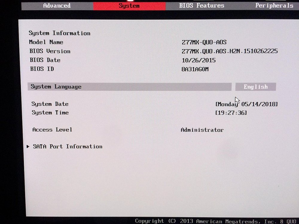

hi @Casm101  @Kynyo
Oh lord im sorry u dont know my spec ;D ive add it to my info page.
Mobo: Z77MX-QUO-AOS
Bios: H2N.1510262225
CPU: 3,5 Ghz Intel Core i7 3770K  (bosted to 3.9Ghz)
GPU: GeForce GTX 650 1gb
Storage:  Samsung evo ssd 500gb+ ssd 240gb + Hdd 2x WD red 2tb raid + 1x WD 1TB + WD 500gb (MacOS EL Capitan 10.11)
RAM: 16 GB 1600 MHz
Display: 2x Eizo cx240
the thing is when i try to upgrade EL capitan i had black screen or apple logo freez.
what is the strongest geforce GTX working with my machine? i need something strong for video edition.

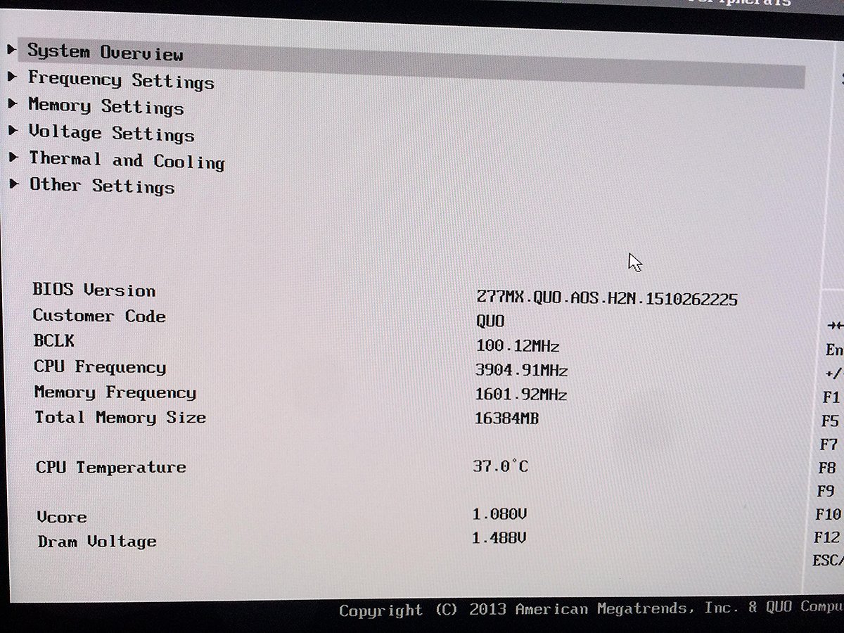

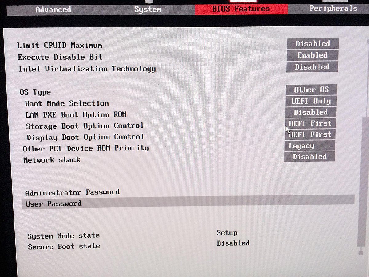

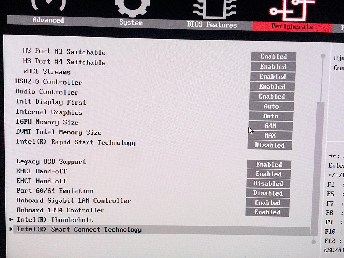

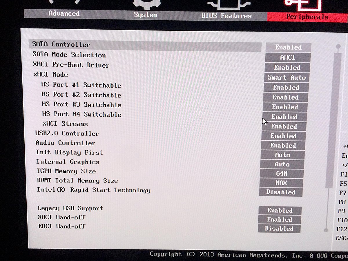

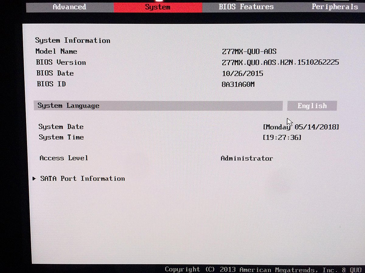

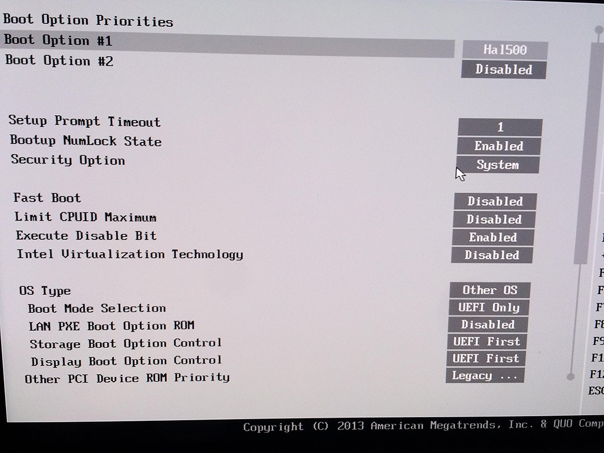

can u tell me how to set bios setting to ? Thanks you so much!
1.thumb.jpg.95da31bf1532ab56bff711776b48acd0.jpg2.thumb.jpg.527d556c15a98c3b7bbaee0a74b98177.jpg3.thumb.jpg.ce2faf06595bdf1ee9e9ef9a5ff966af.jpg4.thumb.jpg.e1f0cd87f8d75f4e3be638b91d1aa2d3.jpg5.thumb.jpg.fb4ddc823589dd0e0ac30b0311110420.jpg6.thumb.jpg.ddaca4d855dcaf900ad8595e65db0ff2.jpg
The H2N firmware does not natively boot OS X.
If you have a El Capitan installed and working on it, it was not done the way it was meant to be for this board.
Did you installed it yourself ?
Edited by IronManJFF
GTX10x will work, dont worry
There are no guide because basically after you flashed the firmware and with the proper Defaults.plist, you just install it like a real Mac.
So , you have a El Capitan that you want to upgrade ...
Is it working ? or just installed ?
plz tell me how you did install it ... Clover ? Multi-B.... ? some other way .. we might have to clear some left-overs that will bite you in the butt...
If it is installed and working, what does it believe itself to be  (About this Mac) ?
All these other drives beside the WD 500 (El Capitan) .. what are they for ?
