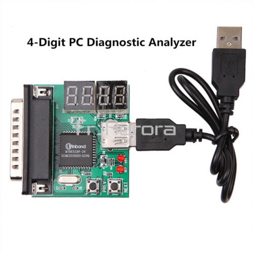

I tried both versions (I have several installs on different hard drives so easy to swap one quickly) and same result. Is there any way to see on the bios level if it sees the graphic card?
You may give a try to this : https://m.ebay.fr/itm/4-Digit-PC-Laptop-Analyzer-Diagnostic-Motherboard-Tester-USB-PCI-Post-Test-Card-/263121920044?hash=item3d4349e02c%3Ag%3AZt8AAOSwl5pZgt5v&_trkparms=pageci%253Ae82c03de-8cb4-11e7-ba26-74dbd1809838%257Cparentrq%253A2df29a3015e0a9e46f6e9e4fffffabe0%257Ciid%253A14
There is some hardware who can do it as well: google pciexpress diagnostic card.
Hope it helps.
