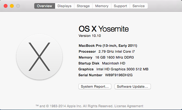

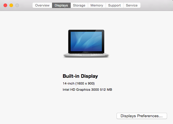

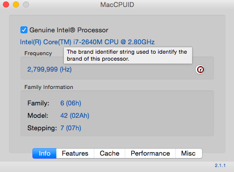

Swapped ACPI and config files in EFI, turned off machine, swapped screen and CPU (and screen cable), turned on machine, reran SSDT command.
Amazing. The i7 is noticeably faster with certain tasks. I chose not to put a quad core i7 in (which is possible) because of rumored heat issues and higher TDP on the chip, but I might end up with a T430s soon anyway.

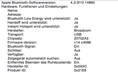

Hello,
I am interested in getting handoff to work.
With a bluetooth module of T530 it is possible with patch from this thread.
http://www.insanelymac.com/forum/topic/302410-patch-enabling-handoff-for-non-apple-bt4-devices/
My WIFI card is a BCM94322HM8L (14E4:432B) which has to be driven by AirPortBrcm4360.
​I got it working by modifying info.plist of AirPortBrcm4360 and AirPortBrcm4331 and deleting AppleAirPortBrcm43224 kext
It didn't work for me trying to use InfoPlistPatch. Please help to figure that out.
