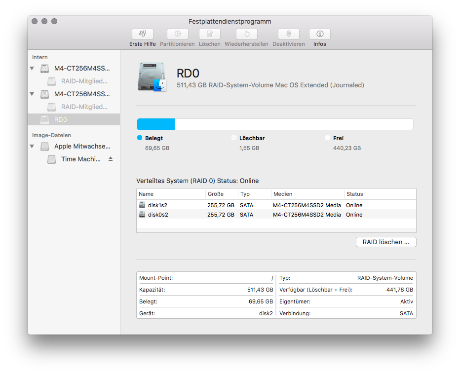

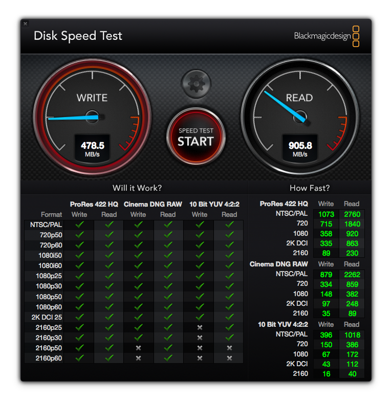

pcace Posted October 22, 2017 Share Posted October 22, 2017 assuming you can get the bay drive to work you can easily build a raid. i ran into issues somewhere around Sierra 10.12.3? so i had to give up using the bay drive. i dont know what happened. Hey, just a little confirmation: SoftwareRAID0 works out of the Box! (created softwareraid while installing, then the only postinstallation step was to copy the EFI folder to both (!) EFI partitions of the two RAID0 members... But be aware that there is some seriouse issues when updating to High Sierra since it seems that apple forgot the support for afps+raid0 (https://forums.developer.apple.com/thread/78908) Thanks again for everything! PS.: USB3.0 fixed itself after the reinstall by just copying the newest generic USB3 driver (https://bitbucket.org/RehabMan/os-x-generic-usb3/downloads/) to /Library/Extentions (see speedtest in the attachment) Cheers 2 Link to comment Share on other sites More sharing options...
pcace Posted October 22, 2017 Share Posted October 22, 2017 Hey, just a little confirmation: SoftwareRAID0 works out of the Box! (created softwareraid while installing, then the only postinstallation step was to copy the EFI folder to both (!) EFI partitions of the two RAID0 members... But be aware that there is some seriouse issues when updating to High Sierra since it seems that apple forgot the support for afps+raid0 (https://forums.developer.apple.com/thread/78908) Thanks again for everything! PS.: USB3.0 fixed itself after the reinstall by just copying the newest generic USB3 driver (https://bitbucket.org/RehabMan/os-x-generic-usb3/downloads/) to /Library/Extentions (see speedtest in the attachment) Cheers ok, it seems that i have been happy to early ;( since i did a complete reinstall i havent updated to 10.12.6 when i did the last posting (it was still on 10.12.5). So now i did update osx and: i cannot boot the machine completely - or better: I dont get to the loginscreen. Everything fires up fine, but then at the second i normally would get the login i just get a black screen. Sh**. So what now? I am using the T420 without a Nvidia. What can i do to fix that? I already tried to use the Stock boot.plist from the provided donwload, same reaction. Any Help would be just amazing!!! Link to comment Share on other sites More sharing options...
