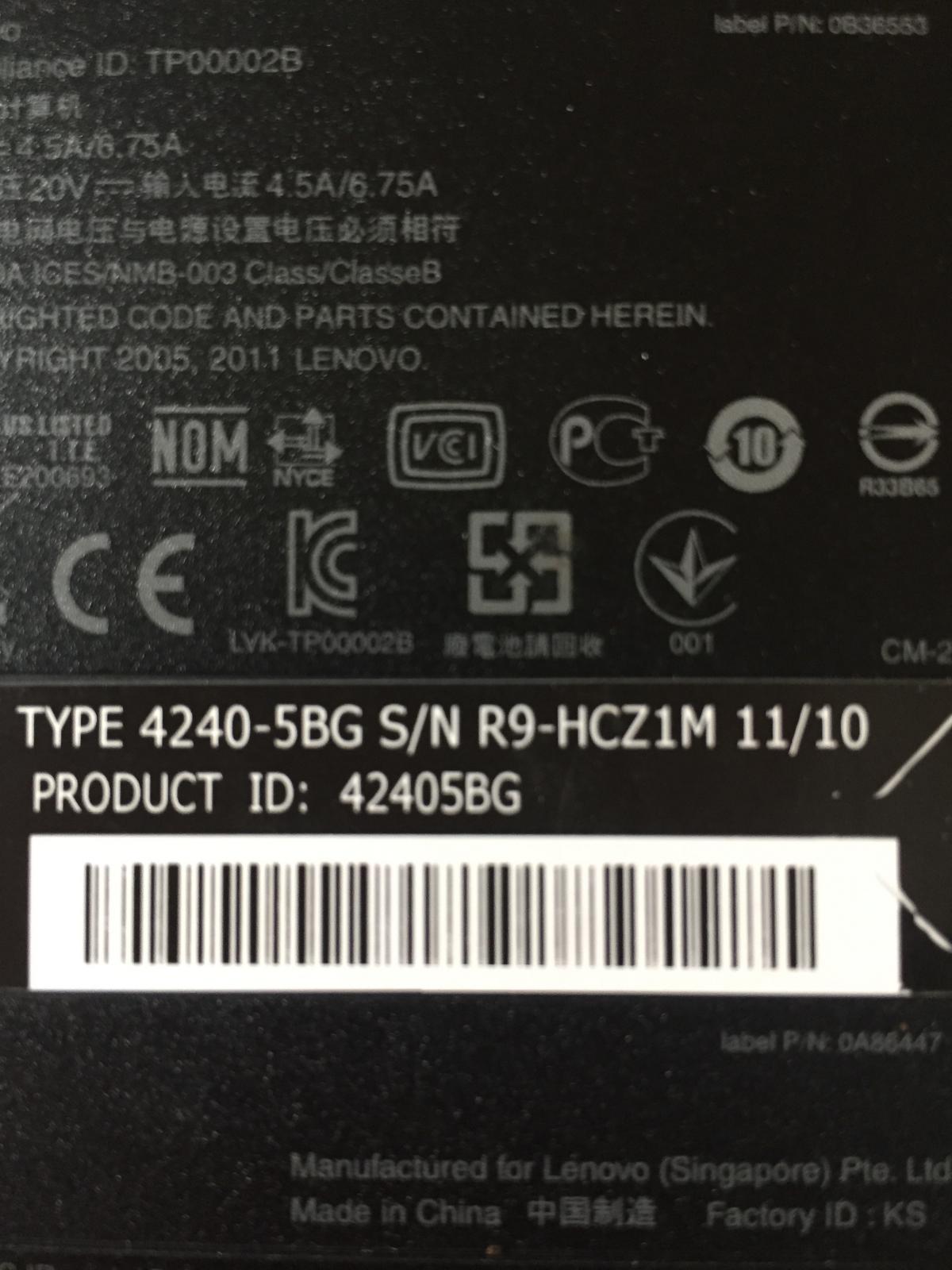

Hello everyone! Could I ask you if anyone has got a Lenovo T420s to give me a hand. I have problems with BIOS so I installed mod 1.41. If I put 1.43 of Lenovo, the installer doesn't start. Can you kindly help me with this matter? Thank you very much

Thanks for your help but the last BIOS org lenovo is 1.43, and I found 1.41 mod and whitelist. If i put 1.43 org doesn't start installer.
