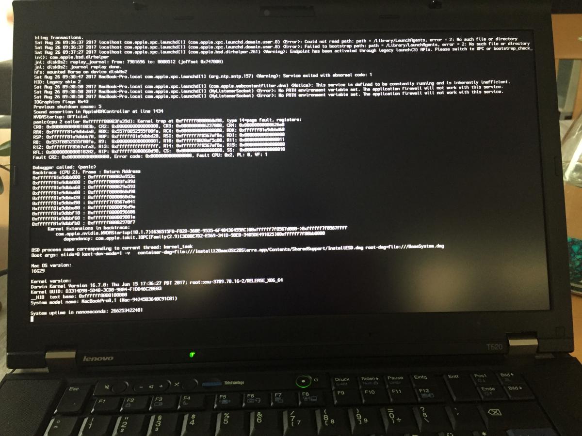

Lawmanwilly Posted August 26, 2017 Share Posted August 26, 2017 Hello in the Group I have been struggling trying to use this guide for my T520. See here the error that i am getting. Sound assertion error. AppleHDAController. From what i picked up in this and other forums is that it my be related to to the graphic settings. I have followed the Bios setting in the guide and am using the 1600x900 config.plist file. I have tried older releases with no avail. I have tried El Capitan and Sierra both generate the same error. Maybe somebody has a tip how to move forward. Many thanks. Link to comment Share on other sites More sharing options...

Lawmanwilly Posted August 26, 2017 Share Posted August 26, 2017 @long0311 - what did you change exactly? I have tried all 3 settings. Integrated (there is never stays, it jumps back to Discrete after the reboot), Discrete, and the Optimus mode. Optimus shouldn't work and it does not with this package. So what exactly did you change ? thx for the info, law Link to comment Share on other sites More sharing options...
long0311 Posted August 26, 2017 Share Posted August 26, 2017 I change: in BIOS setting Config tab->Display-> Digital on thinkPad if wont work try: add dart=0 in boot options Link to comment Share on other sites More sharing options...
avdo Posted August 26, 2017 Share Posted August 26, 2017 @Lawmanwilly, I take it your attempting to run it with Nvidia discrete graphics? If so a Mac Pro 8,1 system definition is not what you want for starters. Have you patched your own DSDT or are you using the one in the zip file? I can help you with a discrete graphics install but you'll need to do the following: Post a zip file of acpi dump obtained by pressing F4 at clover menu. Files are saved to Clover/Acpi/Origin folder. I need to know the model number of the T520 as well Link to comment Share on other sites More sharing options...
eman.morales Posted August 26, 2017 Share Posted August 26, 2017 use Clover Configurator to edit the .plist. look at ACPI and uncheck all the fixes, they are causing the kernel panics when just trying to boot into the installer. also creating an smbios then trying to boot with the acpi fixes will not work either. I dont know what will stop working from unchecking the fixes, and I do not know why they cause the kernelpanic. @Lawmanwilly,I take it your attempting to run it with Nvidia discrete graphics?If so a Mac Pro 8,1 system definition is not what you want for starters.Have you patched your own DSDT or are you using the one in the zip file?I can help you with a discrete graphics install but you'll need to do the following:Post a zip file of acpi dump obtained by pressing F4 at clover menu. Files are saved to Clover/Acpi/Origin folder.I need to know the model number of the T520 as well Do you know how to get the discrete nvs 4200m working on the t420? Link to comment Share on other sites More sharing options...
