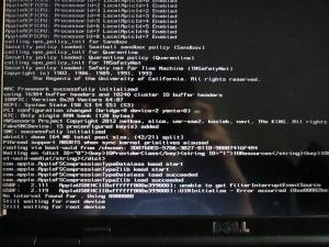

Do anyone know how to install Mountain Lion on Dell XPS 15 L502X?
I tried typing GraphicsEnabler=N cpus=1 busratio=20 with and without -f or -x or
npci=0x2000 or PCIRootUID=1 but not thing is working. I can't even boot into iATKOS ML2 usb installer and i know the iATKOS_ML2.dmg file is working because i installed it on my other laptop.
The USB is already setup with ML2 Bootloader_installer.pkg and restore with iATKOS_ML2.dmg
Every time i boot the USB, i have a no smoking sign but without the cigarette so i boot in to verbose boot (-v) i got an error. It said "Still waiting for root device." :huh: -> :o-> :shock: -> :blowup:
Dose it matter if i update the bio to the latest version and what should i do???? :wallbash: :help:

Thanks for replying. It is still did not working. I checked the bio and tried theLegacyAppleAHCIPort.kext and
AHCIPortInjector.kext but it did not work.
I discover something i tried booting iATKOS ML on a Lenovo laptop and it did not work and have same problem as my Dell XPS15 L502X. Before "Still waiting for root device", it have "No  interval found for . Using 8000000" on both Dell XPS and the Lenovo laptop. I wonder if this information will help??

You mention in your other topic(which I have now merged with this one) your USB installer works on other laptop so you know it's good, but then now say it doesn't work on other laptop, which is it? Also when using any injector, only one can be installed. You can instead try this one I updated to include support for newer chipsets not included in the legacy versions. Use -f when booting to be sure it loads and your not booting from cache. Hopefully this is right version, I need to clean up my Dropbox :)

I just added the kext at the USB in Extra/Extension and I still the error. Inside E/E folder there ElliottForceLegacyRTC.kext and IOPCIFamily.kext. Will those kext cause the error???
This is from the org.chameleon.Boot in E/E folder. I wonder if this will help.

add to System/Library/Extensions, haven't used Extra/Extensions since Snow Leo since newer OSX versions handle cacheing differently and kexts cannot be cached from Extra.. org.chameleon.Boot.plist should be in /Extra and NOT /Extra/Extensions/, EliottForceLegacyRTC.kext should be deleted, personally I have yet to set up a hack where it didn't cause a KP so it' beyond me why it's included as a default kext in these distros unless they are targeted at users will old hardware only. If you still have trouble after that, I would suggest not using a distro because with all the generic crap that is added in an attempt to make it work on most PC's, you end up spending hours/days trying to figure out which things it added for you are actually causing problems instead. Just follow the Guide in tutorials section and you will have much better success. IOPCIfamily.kext may cause issue depending on version and your hardware.
Sometimes during install injector may not load and SATA device ID needs to be added to AppleAHCIPort.kext, this is usually on H67 chipsets where bios has no option to choose RAID, IDE or AHCI modes and is always in RAID mode based on the device ID.

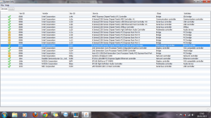

run this in windows on both      System Info, an app to get hardware and kexts info     and post results. looking for device ID and vendor ID for sata controllers

Hi, I found out the Ven ID is 8086 and the Dev ID is 1c03 for the sata control.
