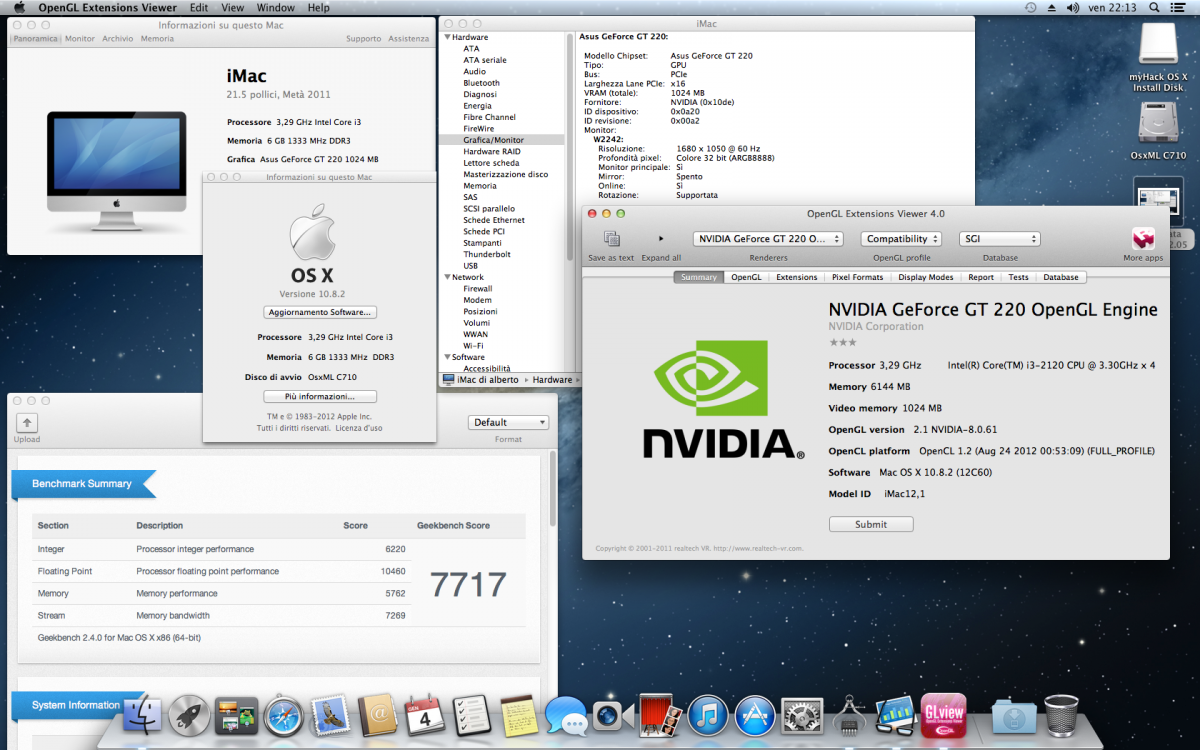

Hi i' ve managed a new retail installation on a Fujitsu C710
I have get all to work at full with some fix now i can't enable only usb 3.0
i can see 2 Usb controller this one :
775]Bus USB 3.0 ad alta velocità:
775]  Posizione controller host: USB integrata
775]  Driver controller host: AppleUSBXHCI
775]  ID dispositivo PCI: 0x7f8200001e31
  ID revisione PCI: 0x7f8200000004
775]  ID fornitore PCI: 0x7f8200008086
775]  Numero bus: 0x14
775]and this one:
775]Bus USB ad alta velocità:
775]  Driver controller host: AppleUSBEHCI
775]  ID dispositivo PCI: 0x1e2d
775]  ID revisione PCI: 0x0004
775]  ID fornitore PCI: 0x8086
775]  Numero bus: 0x1a
I now the frist is for 3.0 xhci also the second is for 2.0 ehci
i' ve try a lot of solutions PXHCD and add my id 0x1e31 in the info.plist of AppleUSBXHCI.kext
but nothing work...
If anyone know how make it on please help me THX.
i'm sorry for my bad english...
Alberto
