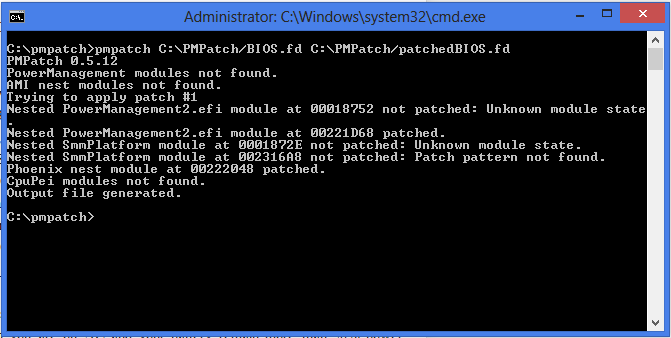

Hello, CodeRush, i have Lenovo G570 InsydeH2O bios 2.09, this is my output, the bios is modded for unlock menu....
localhost:UNLOCK Paolo$ /Volumes/DATI/UNLOCK/PMPatch PIWG2209.bin Prova.bin
PMPatch 0.5.11
PowerManagement modules not found.
AMI nest modules not found.
Trying to apply patch #1
Nested PowerManagement2.efi module at 0001C6EA not patched: Unknown module state.
Nested PowerManagement2.efi module at 001CC758 patched.
Nested SmmPlatform module at 0001C6C6 not patched: Unknown module state.
Nested SmmPlatform module at 001D5AE8 not patched: Patch pattern not found.
Phoenix nest module at 001B3048 patched.
CpuPei modules not found.
Output file generated.
Its ok????
I don't have try to flash....
There is no patch in the utility to unlock any menus for this BIOS, sorry.
Only 0xE2 MSR was unlocked. Yes, all things are normal in this log.
