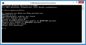

I wrote an utility to patch modern UEFI BIOSes from different vendors to prevent them from locking MSR 0xE2 and therefore make the system with patched BIOS compatible with native AppleIntelCPUPowerManagement.kext.
It's tested on ASUS (AMI), Asrock (AMI), Acer (Phoenix), Dell (Phoenix and InsydeH2O), Lenovo (Phoenix), MSI (AMI), Toshiba (InsudeH2O), Zotac (AMI) and works without any issues.
For Dell users with Phoenix SCT 2.0 BIOSes I added an additional patch to unlock hidden BIOS setups.
The utility is BSD-licensed and available on GitHub.
Compiled versions for Windows and OS X are here.
Latest version is 0.5.10
Usage: pmpatch /path/to/original.bios /path/to/patched.bios
This program is still in development and can produce corrupt BIOS images, try them on your own risk.
I need testers with different boards from different vendors to make the utility better, so if you have enough courage or a spare BIOS chip - please try it and report in this topic.
Thank you in advance.
