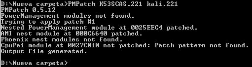

Hi friend, thanx in advance for your work.
I want to ask if the patch was successful.
And... Can I flash the generated file with WinFlash Utitlity?
My machine is a Asus K53SC with Bios 221.
Yes, it was successful. Flash it like normal BIOS file.
