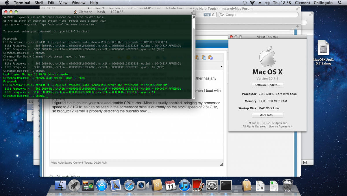

Am I right to say you are both using Athlon processors? ADHDMedia and I are both using Phenom II x6 processors,the detection may be different as I have audio problems using bron kernels rc8 and rc12 but with shane_kernel audio works flawlessly using flag busratio=14

I figured it out, go into your bios and disable CPU turbo...Mine is usually enabled, bringing my processor speed to 3.31GHz, as can be seen in the screenshot mine is currently on the stock speed of 2.81GHz, so bron_rc12 kernel is properly detecting the busratio now....

I don't have that as an option in my BIOS. I am, however , manually overclocked from 3.01 to 3.51 GHz. Could that be my issue? It never has been under SL...
Remove the overclock, test it on the stock speed...should work properly...
You do have the ability to save your current bios settings right? If you can, save them and remove the overclock...
If you require any additional help, we should continue in the help topic
Tested that theory, and its a no-go for me. Even under stock clock speeds, my bus ratio is still detected as 17, throwing everything off.
