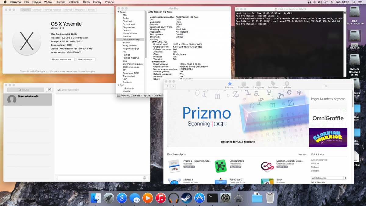

OS: Yosemite
After replacing / rolling back AppleACPIPowerManagement, IOPCIFamily and IOUSBFamily to Mavericks versions (and deleting some unneeded kexts that relied on them and failed to load) it didn't hang at booting to GUI (experienced spinning beach ball of death on grey screen). The only issue remaing is very long boot time 3-4 minutes, didn't time it.
CPU: FX-6300
Started out with FX Yosemite kernel but some apps would crash badly (Adobe Flash installer, Steam), Bronya's RC2 kernel does the trick.
Motherboard: Asrock Extreme3 970
Onboard LAN works with Realtek81111 driver, onboard sound with VoodooHDA, npci=0x2000, SSDT from Rampagedev website.
GPU: Radeon HD7850
Both DVI and HDMI work with QE/CI. HDMI audio required messing with patched AppleHDA and specifying PCI IDs in both AppleHDAEnabler and VoodooHDA so they wouldn't clash over audio devices.
I'm using Enoch's Chameleon fork, installation media was prepared with Pandora's box 2.0 in Mountain Lion VM.
What surprised me that AppStore and iMessage worked out of the box as most people have issues with that it seems.
Thanks for all the great work that devs do and the help that's provided around here.
