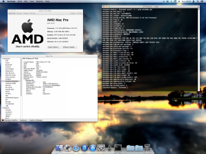

Installed Mavericks 10.9 using Pandora's Box and kernel from Andy. Updated to latest kernel from Bronya (Beta RC1)

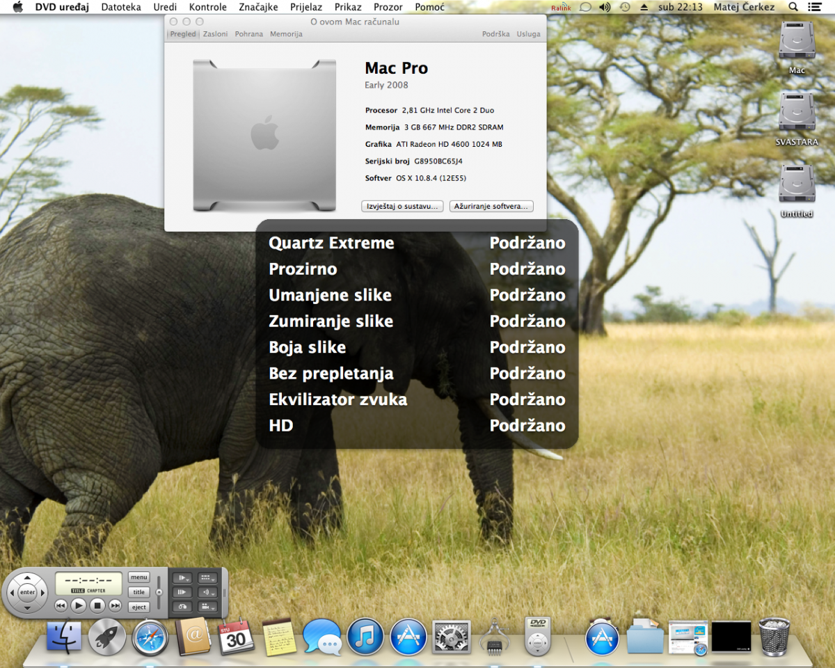

CPU: AMD Athlon II x2 240 2.81 GHz
Motherboard: ASUS M2N68-AM SE2 (non AHCI mode, but work fine with AppleNFORCEATA.kext, tank you again: Shaneee)
GPU: Gigabyte Ati Radeon HD 4550 1 GB, full QE/CI, only VGA tested
RAM: 3GB DDR2 600 MHz ( 1x 2 GB, 1x 1 GB)
SATA: Hitachi HDT721032SLA360. 320 GB, DVD Driver work too
USB 2.0: All six ports works perfectly (In BIOS just set USB:FULL SPEED)
Network: Wi-fi: Sweex wlan usb adapter 150N (Works with MediaTek Wireless Utilities + and ID put in this kext RT2870USBWirelessDriver.kext )
                LAN: RTL8211CL (onborad) work fine with (nForceLan 0.64.5.mpkg tank you again: Shaneee)
Sound: ALC662 work fine with VoodooHDA
PS2: Not tested
Installation methode: Pandora's Box USB
Mountian Lion 10.8.4 with Bronzovka 10.8.X
Windows 7 SP1 x64bit
That word: Podržano means: Supported or Work (sorry for Croatian language)
Thanks all of you for this website       :thumbsup_anim:  :thumbsup_anim:  :thumbsup_anim:
Edited by Cexx

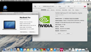

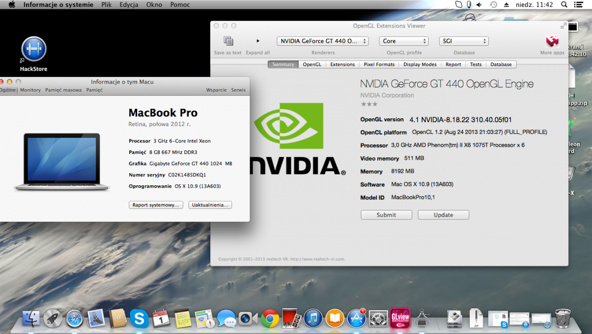

My Hardware :
Phenom IIx6 1075t 3.0 Ghz
Asrock 970 Extream 3
ram 8gb 1333
Nvidia Gt440 512MB
3hdd : Samsung ssd 240 gb, Samsung old one 240 Gb sata 3, WD 1TB sata3
i have working mavericks 13A603 i have done alone ssdt and everyfing is working fine, i have chamelon now but i waant tripple boot clover = win7 kali linux and mavericks over paar days :)
im using bronzovkas kernel test3 the last one work not goed for me ill will be trying
